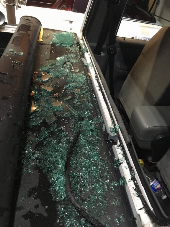

Of course, there is always the chance you'll break it.. and I have broken a couple removing them, but never broke a windshield installing one.
It didn't go well with my Ranger's rear window during the removal process this past fall.... In my defense, the window had a large scratch in it. Note Barracuda in background... I took that rear window in and out without any drama.
