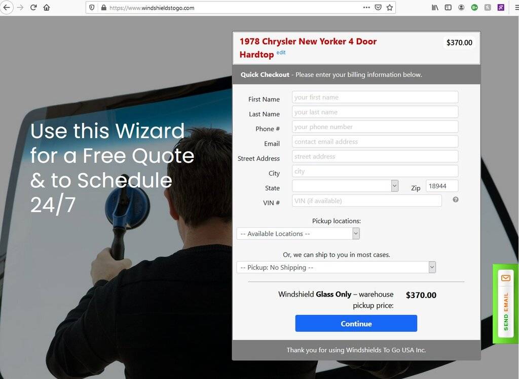

Windshields to Go website says they are. $370
It's worth a try. The worst they can do is say it's not available. Between me and friends, we've bought about 10 windshields off this company in the last 15 years. You pick the closest warehouse to you, and it'll be there in a day or two. You walk in, show your receipt and your on your way with the new glass.

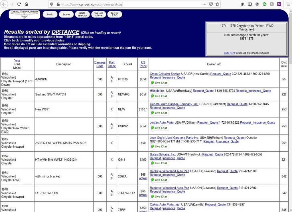

Sounds like baloney to me. Everything that I have says '74-'78 hardtops all use the same windshield, NAGS W821, and almost all '74-'77 sedans and wagons take NAGS W822. The small exception are the cars that had a roof mounted rear view mirror in '74-'75, which take a different number that doesn't have the button glued to it.
How many do you want?
Third one down says it's new, for $100. Has the correct NAGS number for a hardtop.
