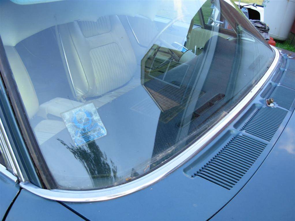

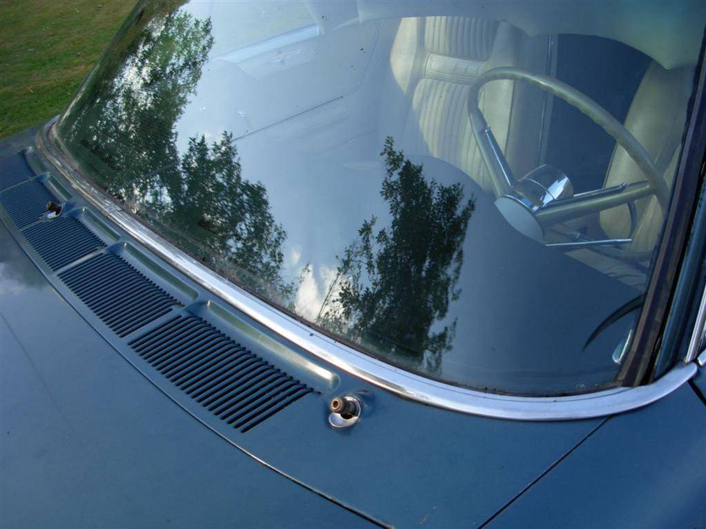

Help! I need to remove the lower windshield trim on my '65 300.I have the top & side trim off but I can't figure out how the lower halves are attached.Can someone point me in the right direction? Thanks! Rod
Here are a few photos...

Piece of cake! Open the doors and you will see a small phillips screw on the end of the moldings. Remove one on each side then with a screwdriver or putty knife gently pry up on the molding and it should come right off. Other than the two screws it is just held on with push on spring type clips.
stop!!!!!
HEY!!!! USE A PLASTIC TRIM REMOVAL TOOL - WILL NOT SCRATCH THE PAINT....course ya just could layer the puty knife with duct tape.....
BUT like previously mentioned these remove VERY easy!!! :headbang:
