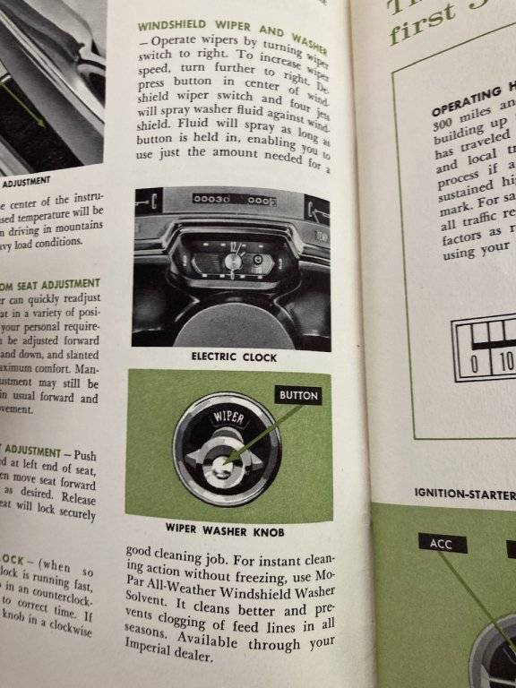

Can someone explain the operation of the windshield switch, mine is erratic and not knowing how it is supposed to work makes it hard to figure out.
Is there a high and low and where are they on the switch? Is it supposed to be variable speed?
Have you looked in your glove box owners manual? Have a factory service manual for? I think I have a nice original available.
Service manual says nothing and have no owners manual.
I was just hoping someone could tell me where low, high and off are supposed to be.
This is out of the ‘61 owners manual.
