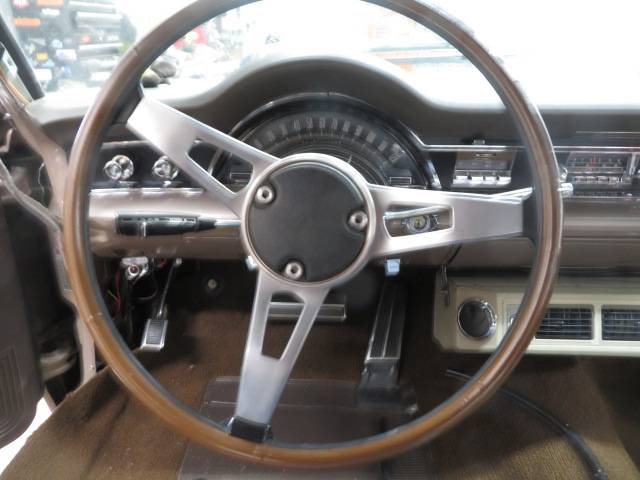

Swap that steering wheel back to normal and it's gonna look great! Elwood knew what he was doing......
Somebody with a 70-72 A or E body will pay a premium for the rimblow steering wheel.
Looks out of place inbyour car...love the wheel just not in a C..sorry.

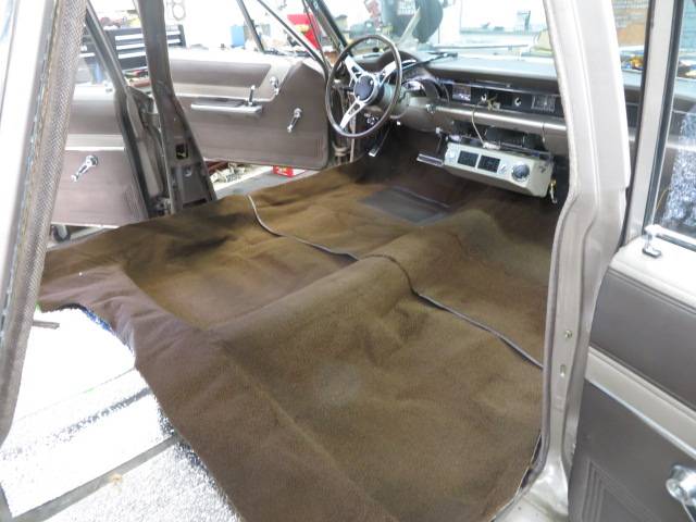

Winter Project Update
With my new found knowledge concerning pictures and narrating them, I thought I would post some more pics of the current state of the 'Party Barge'.

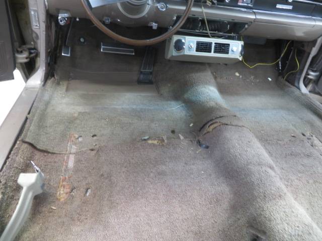

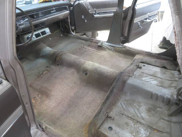

Interior Then: Unfortunately the mouse nest pics are to large to load. Needless to say that is where a lot of the headline backing material went.

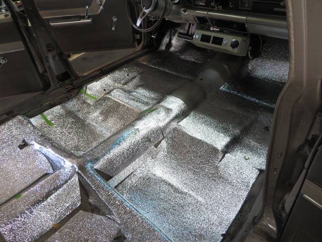

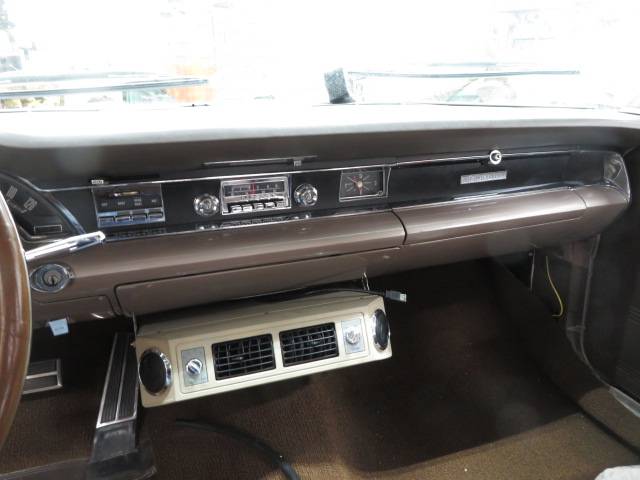

Interior Now:
Still haven't got the front seat back from the upholsterer. Once I do and the weather co-operates, I plan on driving it to his shop where he can remove/replace the headliner. More to come as time permits.
I'd be interested to know if you find the carpet set a bit mis-shapen. Mine came from ACC, and I assume your's did too. I was not particularly happy with the moulding of the pieces.
Richard
Yes, mine came from ACC. The rear section appears that it will not cover the sides of the seats as the original. It looks like it will be lacking a couple of inches which I think I can get from the trimming of the sides.
The front fit fairly decent with the drivers foot area not as large as the original.
Once I get the seats installed (which is after the headliner) I can post pics and narrate on the fit (or lack thereof) of the carpet.

That's weird OMNI that the rear won't cover the sides. Personally, I would advise that you don't cut the thing, and inform ACC of the issue. My issue was that there wasn't enough carpet extending underneath the dash. Unfortunately, I had made some other cuts before I realized this, so I own the piece. ALSO, the carpet was way too big over the transmission hump from front to back. I guess the takeaway is this: really inspect/dry-fit the pieces before cutting.
I had no such issues with my '63 Riviera or '65 Skylark. Those installations turned out fine. And overall, the NYer looks OK too, just not perfect.
