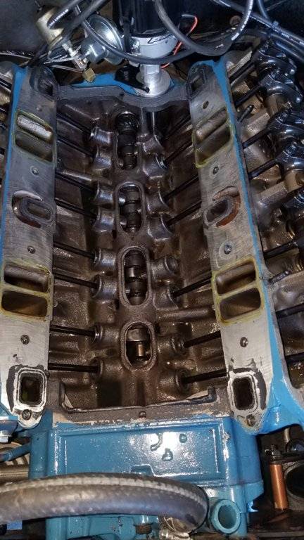

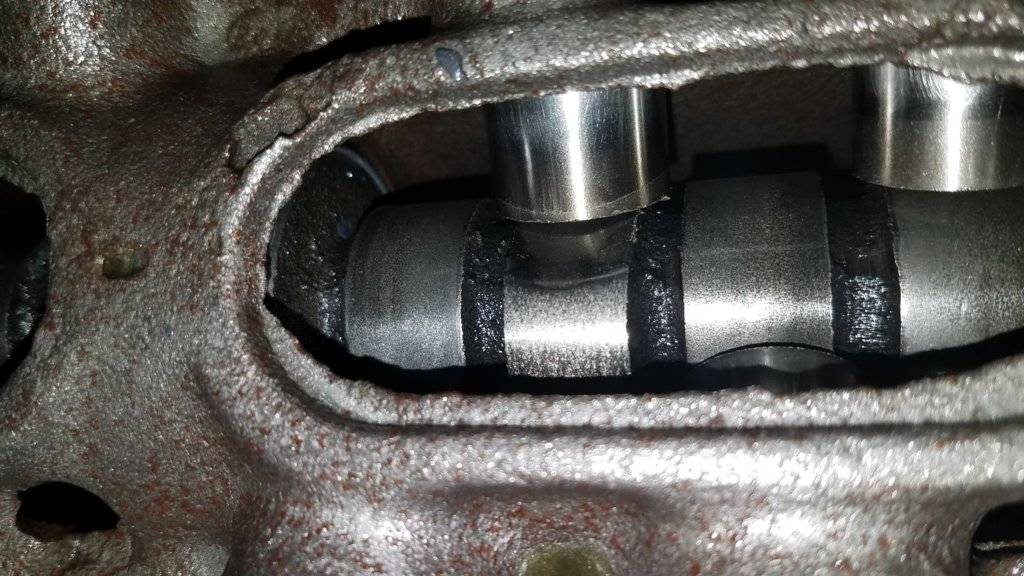

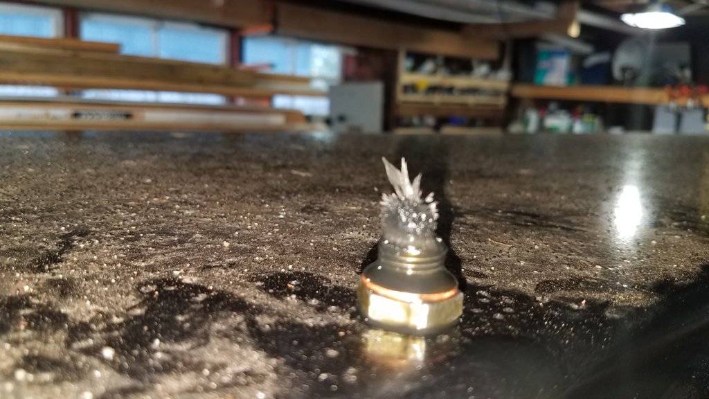

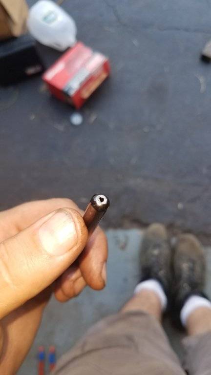

Had a reputable shop put together a 360 for me ( I was impatient). They talked me out of the roller cam . I have heard nothing but horror stories from people putting in flat tappet cams and wiping them out. Now I'm a statistic. They assembled intake to pan , installed the distributor and primed the oiling system (.they even sent video). Not sure what lube they used but they said it was break in oil. All I had to do was dress it /install it and fire it up. We filled the bowl with fuel and as soon as we got it going brought it up to right about 2k rpm ( reading off a digital timing light ) for the 1st 10 min it sounded pretty good , then we started to hear some lifter chatter nothing too bad. After about 15- 20 min of breaking in it was laboring when we let off the throttle , we didnt want to stop the break in process but it backfired and stalled ... pulled valve covers and had #3 exhaust rod out of the lifter... lifter was like a plunger when we pushed down on it with a rag. . It was to hot to do any more surgery and I was too angry so the next day I pulled the intake and saw the damage. Smoked cam and # 1 intake pushrod was wedged on the corner of the lifter ( still don't know if I kissed the valve)

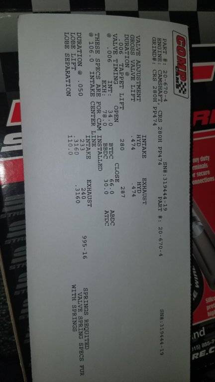

What I can’t understand now is years ago we changed a lot of cams (remember the sbc’s with soft cams) and rebuilt many engines. I never had a cam wipe out so why is it such a problem now especially considering we have all these high tech break in oils now. I always precleaned the cam and coated in a heavy type of oil additive then don’t touch the lobes. My personal opinion is the quality of the parts aren’t up to snuff.
If it’s a big cam did you use break in springs or at least remove the inners coils from the dual spring. Pain in the azz but worth it. Also Comp offers a coating that helps with break in. It’s not just Comp. I’m hearing this from a lot of cams company’s. The EPA oils these days are terrible

Your not the 1st person who's said that... I'm believing it. I wanted to run a lunati roller the shop swore comp flat tappet was perfect and said not to worry it wouldn't be an issue.

I will bet the rent the lifter on the flat lobe was not spinning ever. The FIRST thing you do after you button up the valve train on a flat tappet is turn the engine over and see if ALL the lifters spin and by spin I mean they should turn like they are all geared to the camshaft. If any don't turn or aren't consistent with the others, you need to remove them and check the lifter bore and the lifter itself to see why.
More times than not it's the lifter itself that is the problem, not the cam but the root cause of the failure is just taking parts out of a box, slamming them in and firing it up.
