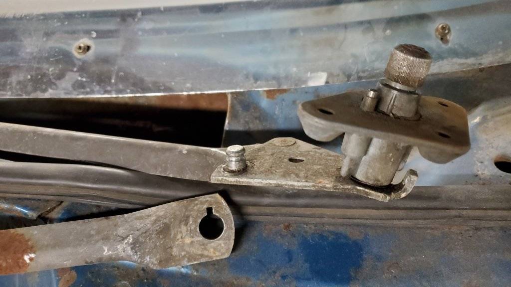

Aug 18, 2022 #1 74monacoHT Member Joined Jul 26, 2022 Messages 52 Reaction score 54 Location Bedford County, Virginia I know about the plastic "cup" bushing, but what else actually holds these together? 74 Monaco 2dr hardtop, 2 speed wipers.
Aug 18, 2022 #2 Justin Plant Well-Known Member Joined Nov 11, 2021 Messages 634 Reaction score 661 Location Moneta, VA tension, thats it
Aug 18, 2022 #3 thethee Senior Member Joined Feb 13, 2021 Messages 1,285 Reaction score 1,505 Location Netherlands You see that groove on the pivot point? That locks on a ridge inside of the plastic cup
Aug 18, 2022 #4 halifaxhops Retired USAF MSGT (SW) yes navy also. FCBO Gold Member Joined Mar 10, 2017 Messages 3,271 Reaction score 1,967 Location HALIFAX PA make sure you greas them when you change it. Just the part the ball goes in. FYI
