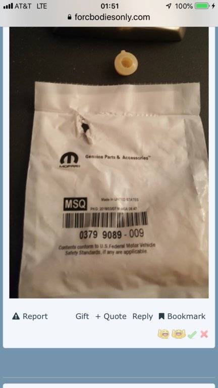

Sounds like you’ll need these:

Do you have the part number? My 77 New Yorker stopped working a long while back I know it's the bushings
Yup should be no problem at your friendly neighborhood Dodge Dealer ...up here $8 canuckbucks each
Crook Dodge wanted $9 a piece for the bushings. I offered $5 a piece for a whole bag of nine and replaced all of them on both Formal's.
