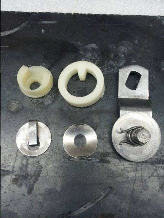

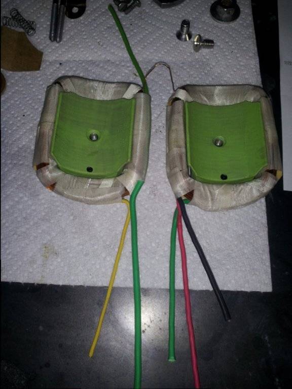

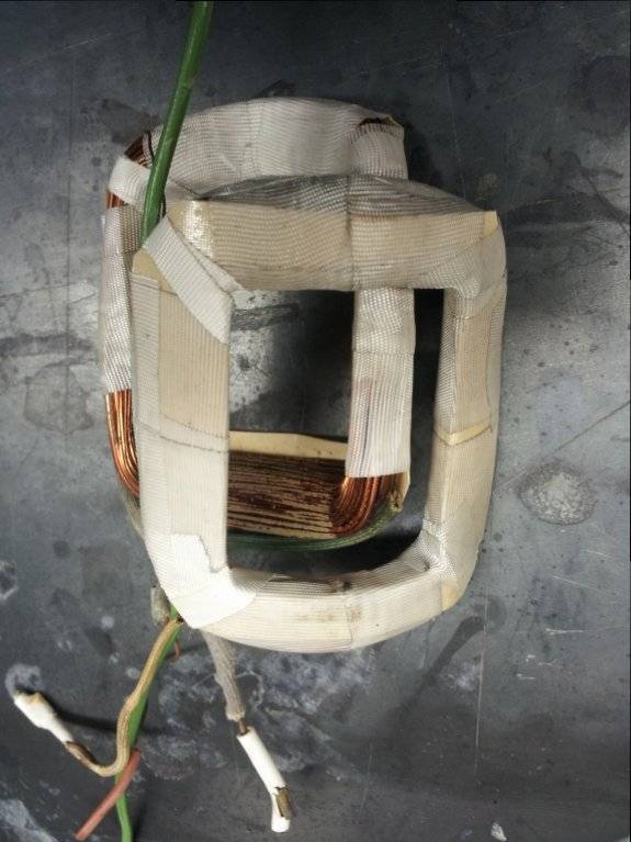

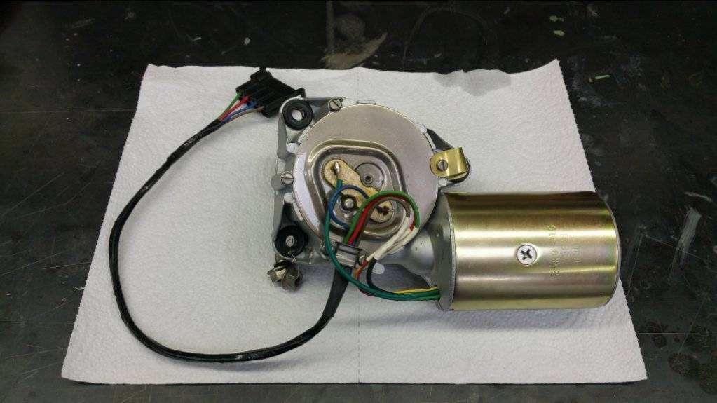

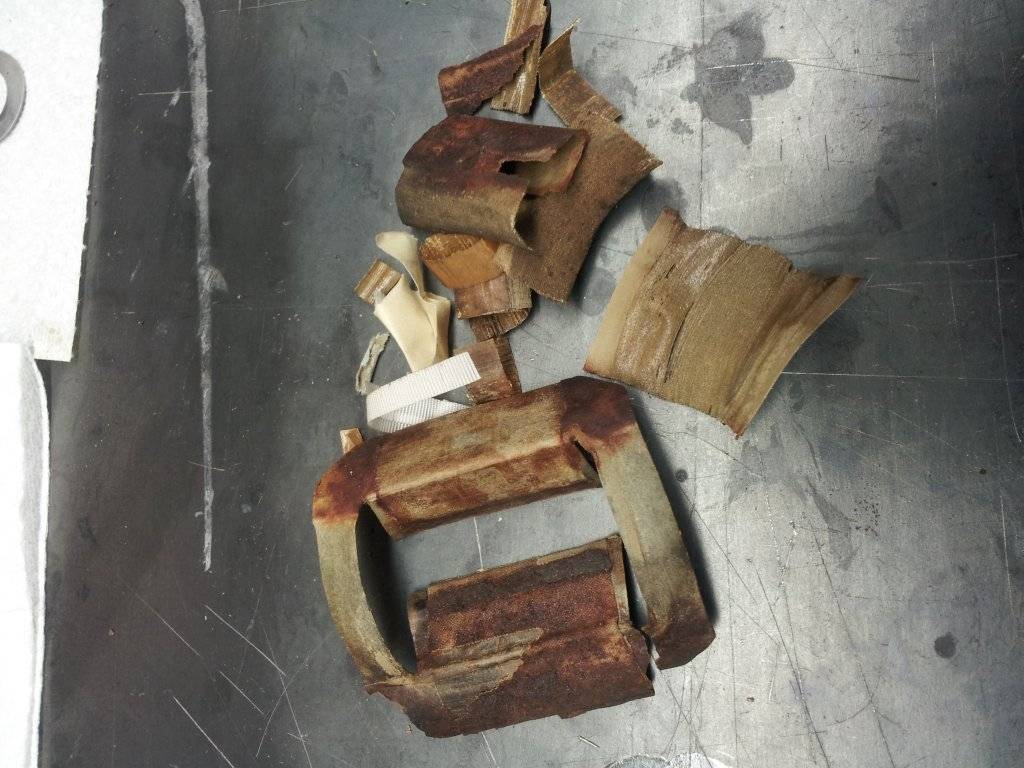

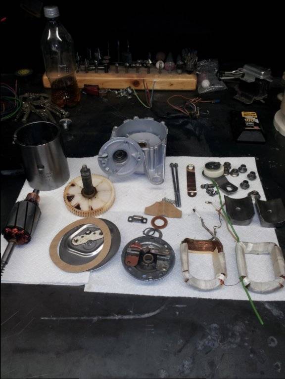

I am familiar with prestolite V speed wiper motors having rebuilt /restored one myself. Not sure how similar the 2 speed ones are. I can assume setting either one up in the car would be the same. Typically i remove the wiper arms from the car. Install the new wiper motor and cycle it on and off to make sure the wiper motor "parks". With the motor "parked" and off, then reinstall the wiper arms in the parked position. Not sure if this is of any help or not. Heres a some pix the 67 V speed unit i restored. I used aeroshell 22 synthetic grease on the gears. This stuff is the best. Doesnt harden at low temps. Found a place to re cad plate the motor cylinder too. Yes i am a nut.
