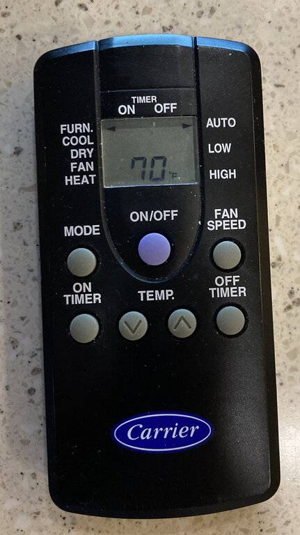

I have an RV with 2 Carrier Air Temp heat pump / furnace units that are controlled with an IR remote control.
I purchased a Cielo Breeze Eco controller that is operated by the front panel or via their app using a smartphone.
I had to walk their support group through the modes and temp ranges for the equipment to have them create a custom control setting for this configuration.
It works well.
Remote for the Carrier unit:
