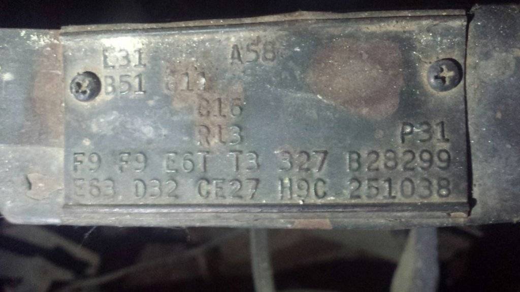

I think these are right, check them against what you observe on the vehicle.
Codes from build tag are:
E-85 440/350
D32 HD A-727
CM27 Chrysler Convertible (Medium)
K9C 440-4, 1969, Jefferson Ave Mi. plant
127350 Sequence Number
Y4 Classic Gold Metallic
Y4 Classic Gold Metallic (Interior accent?)
M6W Upper Door Frame (White Trim)
W1 White Interior
B25349 Order Number
R22 Radio with 8 Track
R31 Dual Rear Speakers
P31 Power Windows
C21 Center Fold Down Arm Rest
P25 Power LH Bucket on 50/50 Seat
B41 Power Brakes (Disc on Front)
G15 Tinted Windshield Only
V7W Accent Stripe (White)
L31 Hood Mounted Turn Signal (Indicator)

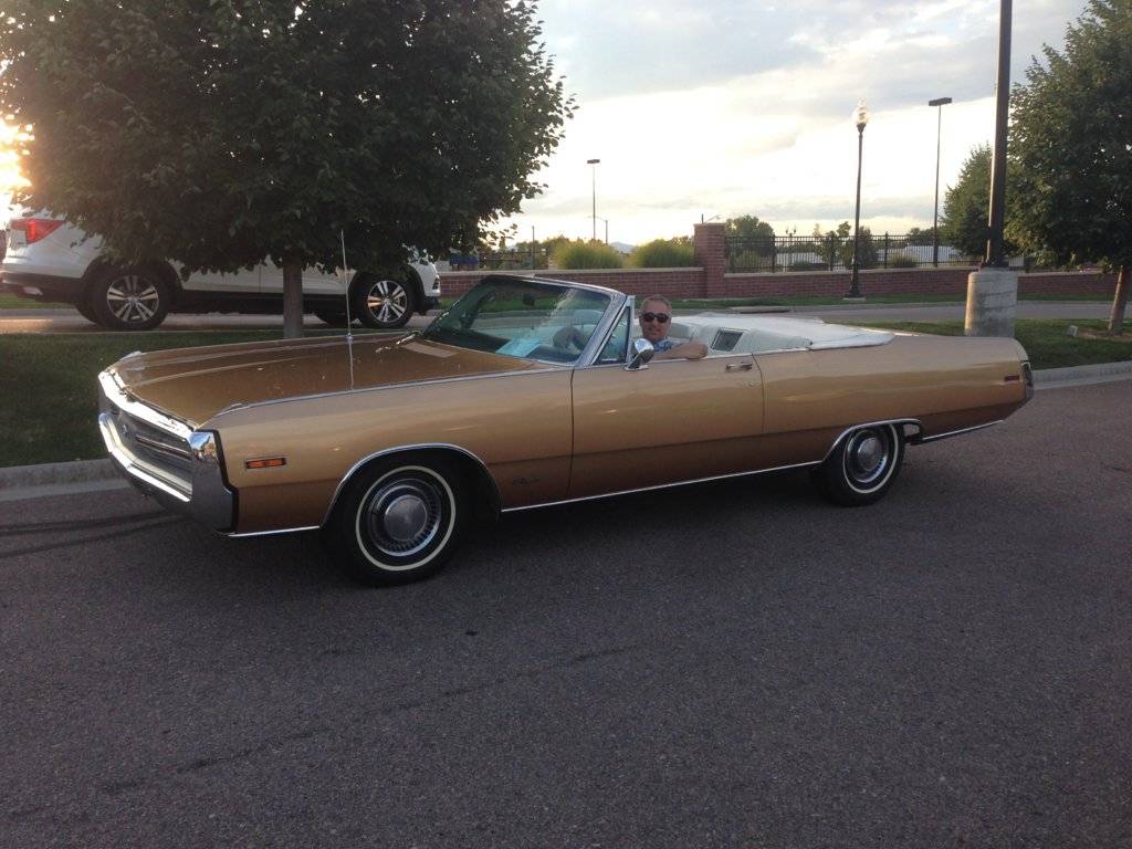

This is a similar color combo to my friend’s ‘70.

Thanks Dave, that concurs with Yeahrightgear. Everything seems to match up with what I have seen in the car except for the 8 track, I am going to have a look at that again.

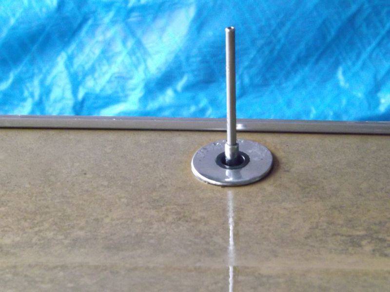

Anyone care to comment on this antenna? It is electric, does it look factory?

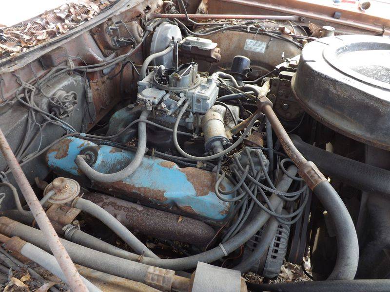

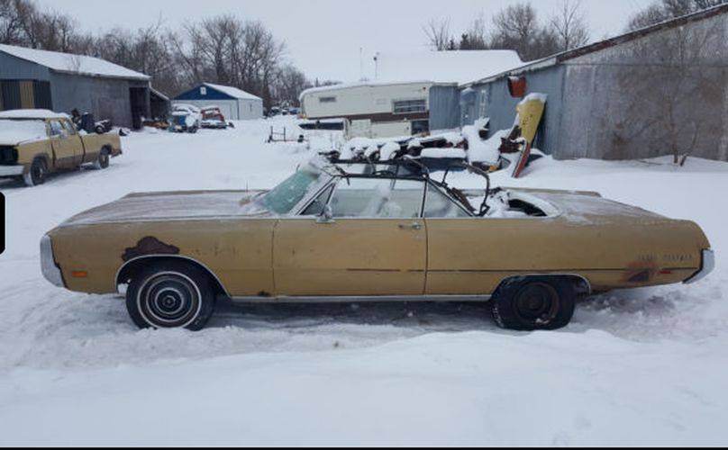

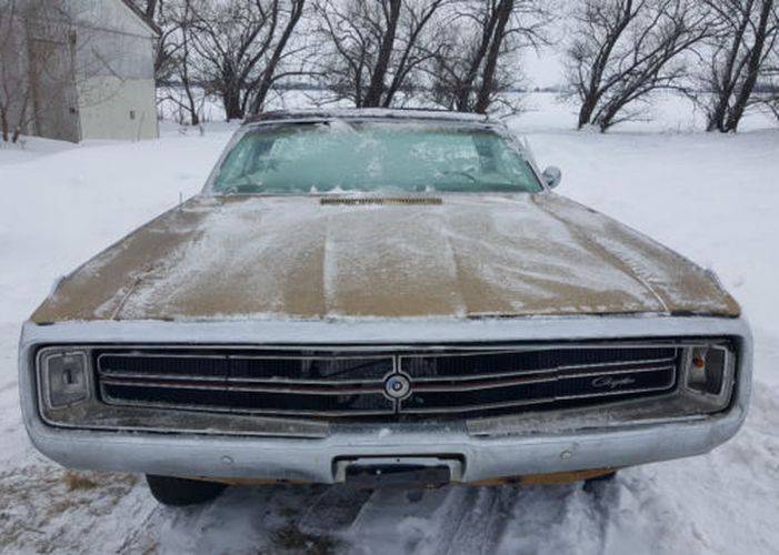

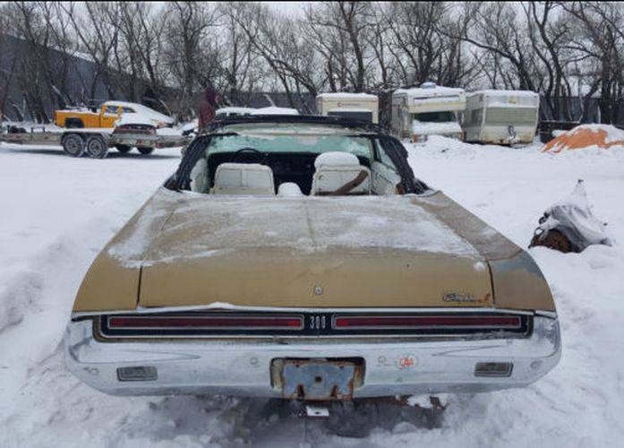

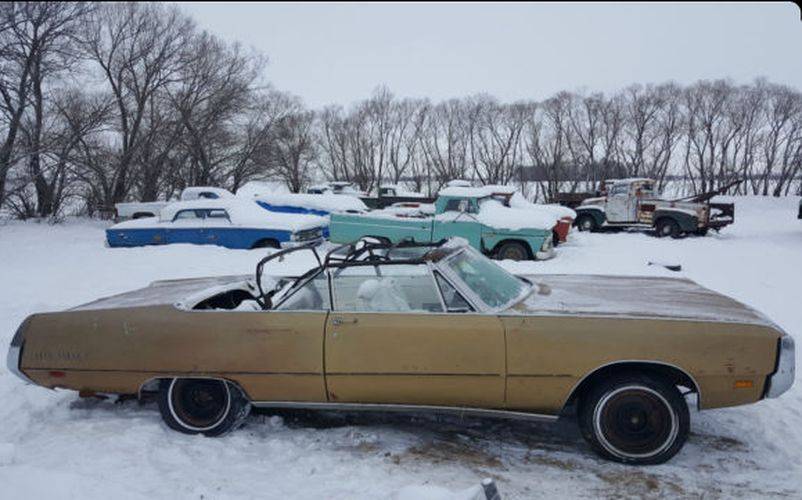

Okay did some net researching, the car came from Canada, Blumenort Manitoba originally, back in May of 2016. The point of destination was to be Stockton NJ at that point in time. I found an advertisement for this car for sale in Pembina North Dakota though with the pics below. Phew!

The factory 8 track was not noted for it's high degree of reliability, someone might well have pitched it for a better radio.

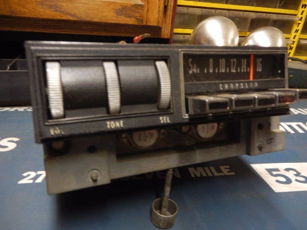

Yeah I do remember seeing a factory radio in it, but it has push buttons as well as three thumb wheels too.
The eight track factory unit had two variants, as I recall, one was an AM-FM unit with six thumb wheels and a balance lever. It also had the push buttons for the radio. The other variant was an AM only unit with the three thumb wheels and push buttons for the radio. If you google "1969 Chrysler factory radio with 8 Track, there are a couple of them for sale on E-Bay.
Dave
One of these bad boys? Might of been removed pretty early on in its life or someone just cared enough to get a NOS part and not do a hack job and lob some aftermarket set underneath the dash.
R22 is indeed an AM radio with 8 track but while R32 is dual rear speakers, I don't believe that is possible in a convertible since there is room for only one, but maybe I am wrong. At least I have never seen that option in a convertible. I have 2 1970 convertibles with the R37 AM/FM stereo multiplex with 8 track tape, and even those don't have dual rear speakers.
