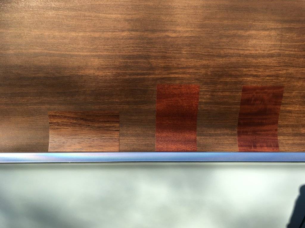

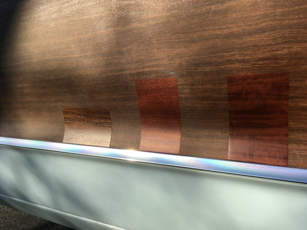

I am looking into an affordable solution to replace my faded woodgrain. Care to offer your opinions?
Left
Middle
Right
All 3M Dinoc Vinyl Wrap
I'm looking for the best look, not necessarily the best match.
Thanks in advance!

3M Dinoc is available in 4x8 sheets I believe, or at least in sheets big enough to do a grain-matched applique on a car. There are a myriad of options with their colours, grains, and for interior purposes (consoles etc) they have various embossing (called "ticking").
The left hand option will be too much woodgrain contrast when seen in large scale on the side of a car. The one on the right however, looks nearly perfect to me.

The sample on the right looks to have a red hue to it, unlike the original. And the original woodgrain now on the wagon is also aged and faded some I would think. Thus the sample on the left might just restore the woodgrain look to original, and not faded/worn as it is now.
I liked the one on the left as appearing most original to me. The one on the right appears a bit deeper with a richer look. I'd probably go with that one IF it were mine

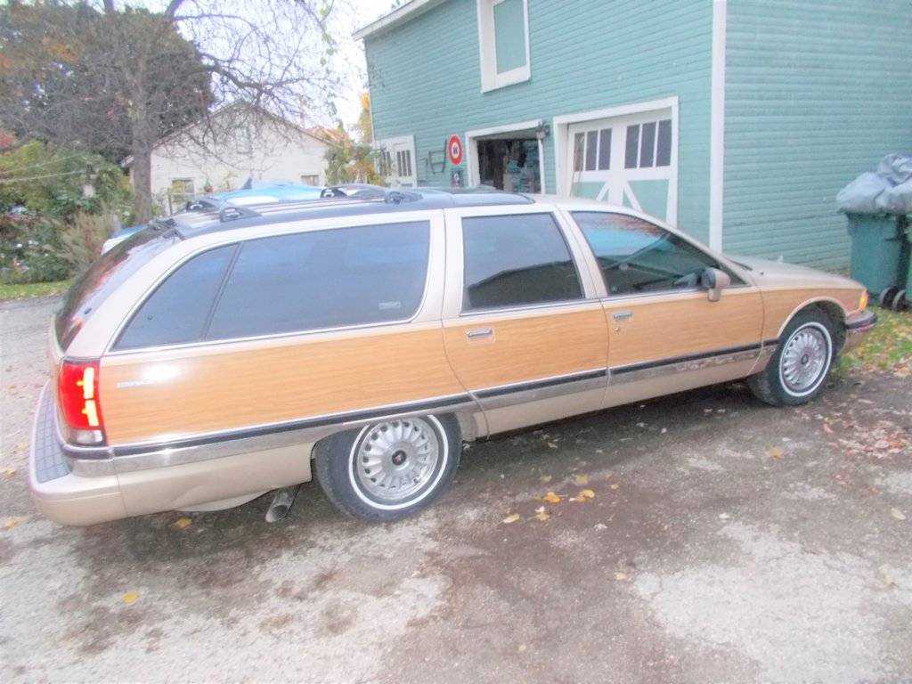

Kathy did the wood grain free hand on my 72, in base coat clear coat, 15 years ago then I cleared it The color and grain were not original but it still looked great when I sold the car in September, I'm having sellers remorse! My new 94 Roadmaster woodgrain is in good original shape except for the surround moldings that are peeling the clear coating! Hopefully I can get her to perform her magic again!!

As far as the three samples you have, I'd agree with what some others wrote, the one on the left (feel free to share the 3M part number/color designation) has a more original look to it. It looks more like "vintage DiNoc as we remember it......
