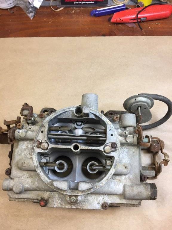

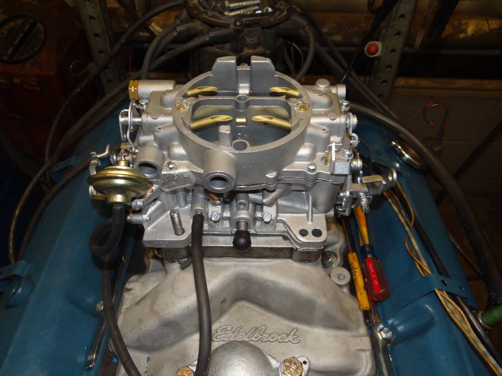

Her's a before and after thanks to Dana! Amazing....
Amazing! I've had quite a few carbs rebuilt over the years but they never come back that pretty. The body of the carb and the linkage and plates look brand new! How do you do it?

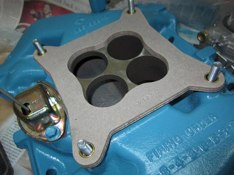

Only complaint/issue is the thick felpro 60123 carb gasket he sent with the carb that went on my Blue 71 as well as Medina.
It seemed to work on Medina, but on the Blue car it created the worst vacuum leak and it would not run. I swapped to a regular thin carb gasket and it fired right up via @Xenon diagnosis over the phone (he is pretty smart for a grumpy old curmudgeon)
