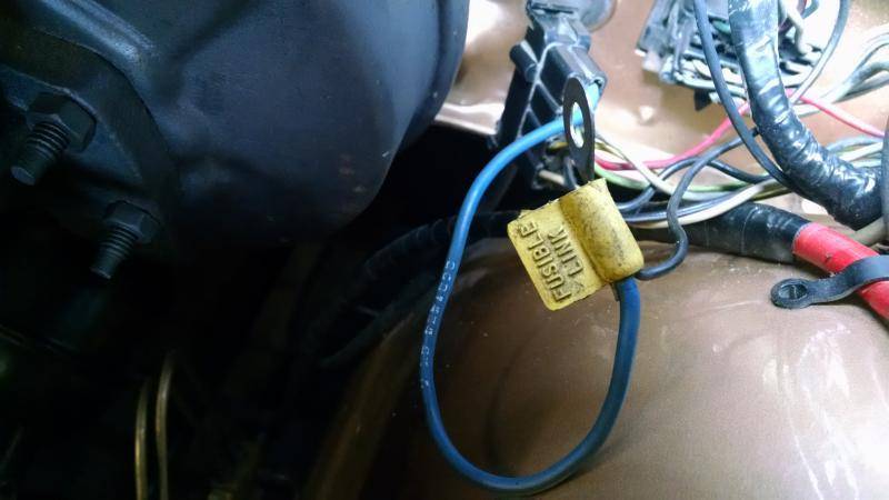

Anyway, is your Fusible Link Harness the same as mine? If so, I will have all the stuff needed to make one for you. All I would need is your original to remove the Fusible Link tag and the cover that goes over the spade connector that attaches to the Bulkhead.
Let me know. I'll be picking up the supplies today and hope to have mine completed today or tomorrow.
Mine is different thanks so much for the offer. I replaced the distributor already that wasn't it but it does run better. Here is a picture of mine IMG_20150617_125755039.jpg

sorry to hear about the continuing problem. You have or haven't replaced the fusible link?
