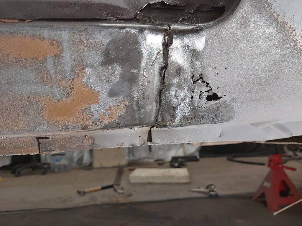

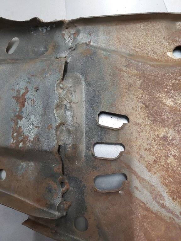

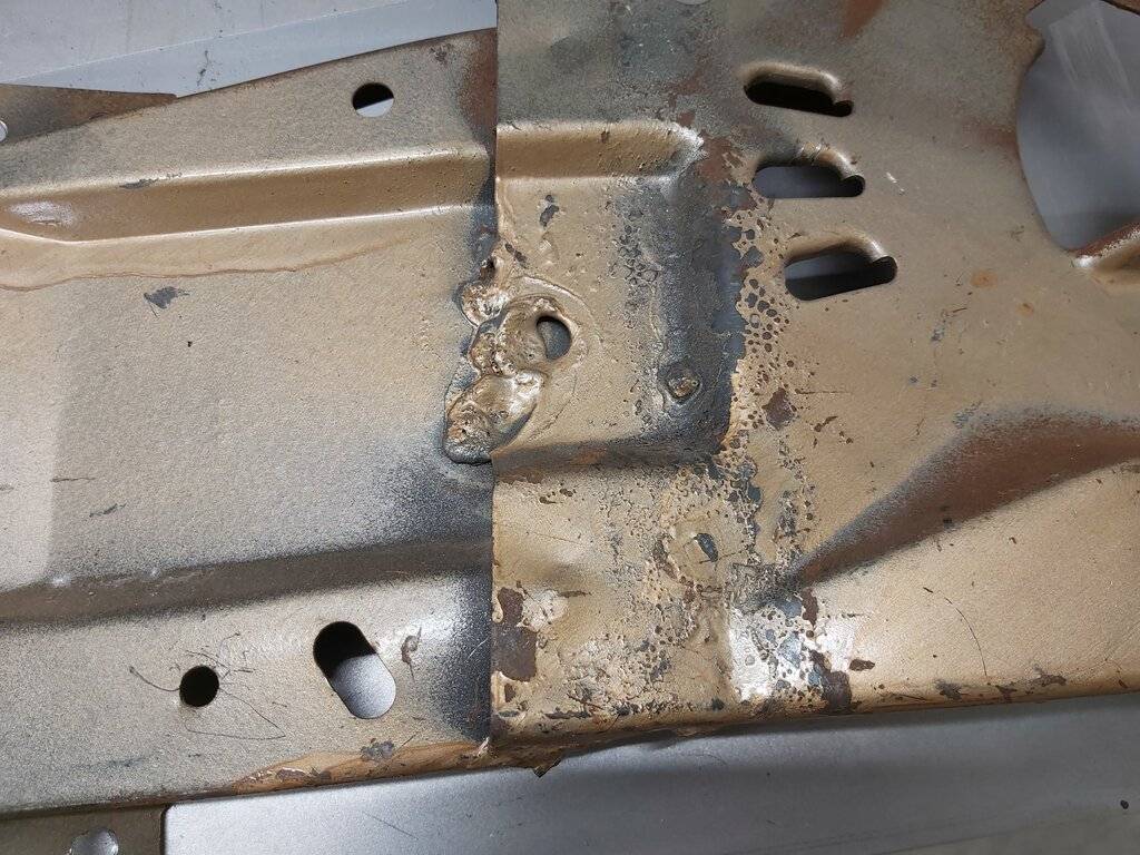

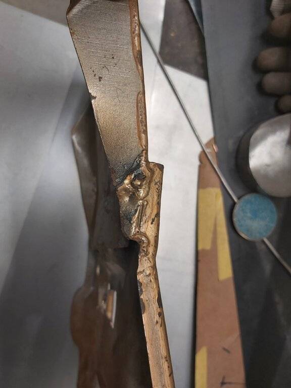

    These welds found from -69 Imp, sad but true (...and somehow funny). I think this should be open for all make and models but factory made.
    First pic from rocker panel/ quarter panel joint, second from rear lid hinge support (this was a reason why lid doesn't fit in a place).
    After all I know I'm not a welder either...
    Enjoy,
    Mika

    The "craftsmen" were in the pilot assembly area, who detrermined the build sequence of which part went where, first, so that the "assemblers" could repeat these sequences consistently with good results.
    In the pictured examples, I suspect that "line speed" might be a factor? Each labor operation has a certain footprint in which it has to happen. In some cases, "just good enough to hold things together" to get it out of the body shop and into paint was all that could happen, I suspect. Once past that point, it was what was. Which is probably one reason there are adjustment slots in most sheet metal items which bolt on!
    Unfortunately, assembly quality did not seem to be a Chrysler "strong point" back then, by observation. At least to the point that it seemed to be with Ford, back then, or what it appeared to have been on the slabs, from comparing our '66 Newport to our '72 Newport Royale (when it was new).
    Enjoy!
    CBODY67
    • Like Like x 1

    It's not really the quality of the weld, but the placement of the items being welded that resulted in the deck lid items not being placed correctly BEFORE they were welded. From what I understand, a segmented weld will deform the items being welded less as there is less total heat involved, which might be why a "tack" is done with the rest being brazed-in with an appropriate material for body panels? All of those functions would have been done prior to the anti-corrosion "bath" the body went through. FWIW
    Understand, too, that the "factory people" know (through destructive testing and such) just how much and little "weld" is needed in particular areas. Segments of welds can result in a stronger, more durable situation than a solid weld that looks better to most of us. With body panels being more prone to deform from the added heat than the thicker stub frame channels.
    Of course, when the pictured body panel welds are re-done in the restoration process, I highly suspect that they will be done more slowly and lovingly than an assembler might have time to take with them. Plus the addition of some anti-corrosion compound to the backside of the repaired area! As no "line speed" issues are operative in getting things done. In any restoration process, there are many items which should be duplicated (as in inspection marks, paint daubs, etc.), but fixing some of the factory mis-steps can just be a part of the whole "make it right/better" situation.
    Enjoy!
    CBODY67
    • Like Like x 1

    Keep in mind that 99.99% of the welds on a body are spot welded, they didn’t need to be welders.
    Alan
