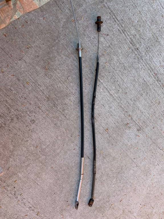

Update:
Replaced the motor mount, you called it Justin Plant! Figured that at $9.- at 'O Reilly's, I just get a new one. Also modified that new mount, thanks Trace 300 Hurst for that link on how to modify it. Works like a champ, no more problems.
As far as the linkage is concerned, yes it is a cable linkage. However, the pic shows the new one on the left and the old one on the right. As you can see, it took a beating! The excess movement of the engine ripped the retainer end right off the cable end, and is probably also the reason why it slipped off the clamp at the carburetor end every time after I clamped it back in place. In fact, this is where my troubles started months ago, so if anyone has a problem with their throttle cable not staying in place, check your motor mounts. The cable also got chafed in multiple spots as it got pulled against the various brackets and weld seam on the firewall. Replacement cable is slightly too long, but it can be modified. Only other observation I have is that the designer who put that hole for the linkage cable in the location where it is, oughta be fired!
Thanks again all for all the replies
