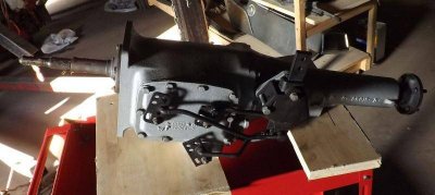

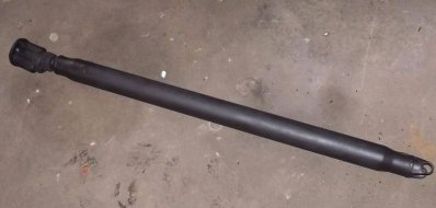

Well i have this with linkage but no bellhousing also i have the drive shaft too. 4speed.jpg4speedtail.jpg
$350 for it all.
