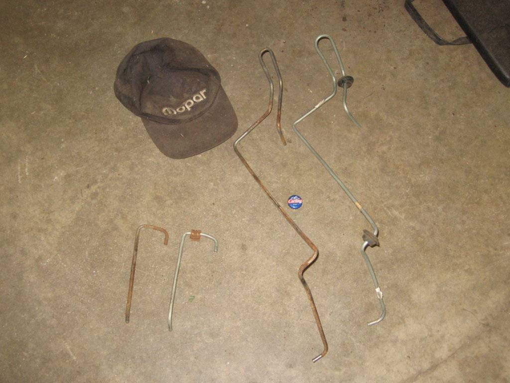

    Being a C....if you can't buy 'em---bend 'em..
