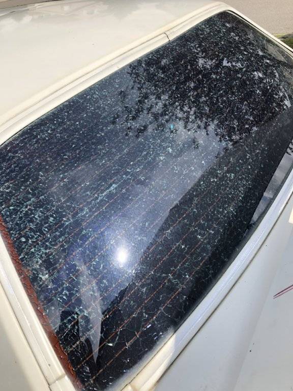

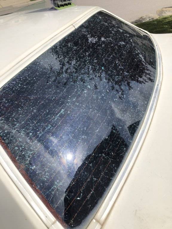

    So walked out this morning to find the back window of my 79 300 shattered! No evidence of something hitting it just completely shattered. Hasn’t been too hot or too cold to be temp related. No interior is in the car so what gives??? More importantly who knows where to get another one?

    Seems to be an oddity of the heated rear glass. Has it been sunny where you have the car parked? This has happened to me a few times, (and yes it does suck).

    I think the tint may have something to do with it. Trapping heat or UV light rather than allowing it to pass through? I could be wrong. I had two friends in high school that both owned 80's RX7's, both back windows eventually mysteriously shattered, both had tint. Coincidence? Possibly. I also agree with traintech55 regarding the suspect defrost wires, both RX7's had those too. Combination of both? A '78 'doba just showed up at pick and pull, fingers crossed.

    Yup the sun shines right on that back window where it’s parked. Wonder if expansion was the issue.

    I had the same thing happen on my convertible in 1971 when the car was only 18 mths old. I drove from Kingston to Mississauga to buy a house and as we were walking away from the car after parking it, the rear window just fell into the back seat and started popping like pop corn. By the time it was finished there wasn't a piece of glass bigger than course salt. Scared the crap out of my poor dog sitting in the middle of the back seat.
    The dealer said it was a common tempered glass failure usually caused by stress in the glass sheet and no it wasn't covered by the 5-50,000 mile warranty.
    If you cover your window inside and out with clear packing tape you might get it out in one piece. I wouldn't be surprised to find some of those glass bits are still hiding in my car after 48 years.

    That'd be enough to do it. I chose to reply to this one because the cause is as close to explained as you're likely to get. Tons of good theories in here. Glass is just plain weird, tempering only helps assure it will break into smaller pieces... IDK if it has any other engineering advantages, but from a practical stand point, that's all you get.
    Because these failures were not uncommon when new, they shouldn't be too surprising as they age. Ever see a 100 year old pane glass window that looks like it has a sag in it? The semi-fluid will get thicker at the bottom over time from gravity, heat cycles, etc.
    Unless you find a true structural deficiency in the car or glass frame, or something jamming the glass from expansion... just replace it and call it a day. Get a cover on it if you want to reduce the direct sunlight it receives.
