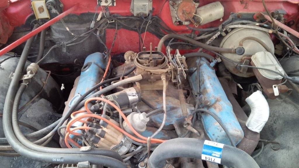

    Hey fellas what would you do with a 1972 Dodge Monaco M-Code 400 2bbl running the original Holley carb? Car has been sitting for a long time....like 30 years long, car runs but won't idle and you need to pump the gas to keep it running.
    I was going to throw a kit into the carb but was advised that those carbs sucked even when new due to the cheap casting.
    I just got it so I am still learning about the car...it still has 6 of its original plug wires so a tuneup is in order but you have to start somewhere.
    So what do you feel would be the best option?
    Thanks,

    I would do the tune up first with new wires, plugs etc. . See if it runs better... and I base that on the old adage of "most carb problems are electrical".
    The carb is pretty simple and if you were planning on keeping it the way it is, I would rebuild it. While they might not have been the greatest to begin with, the car still has the original carb after all these years and that tells me that it probably ran OK for most of its life. The kit is cheap...

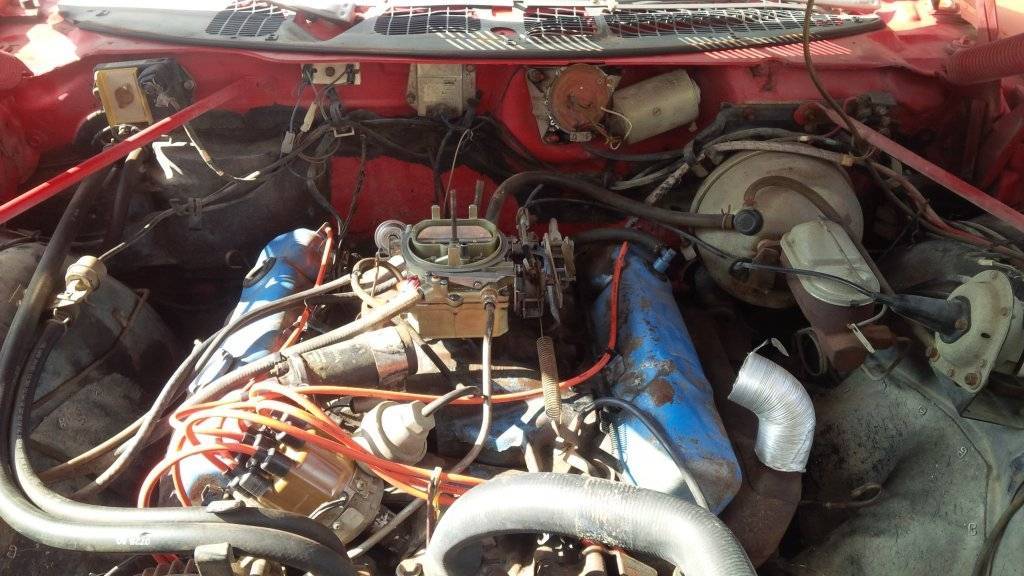

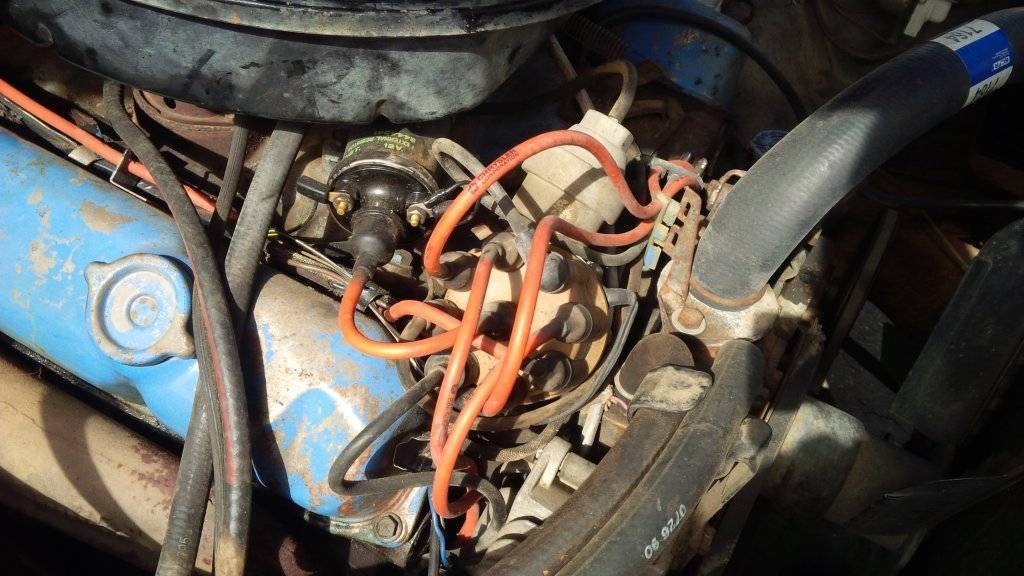

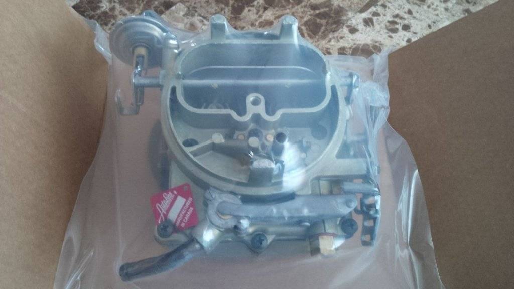

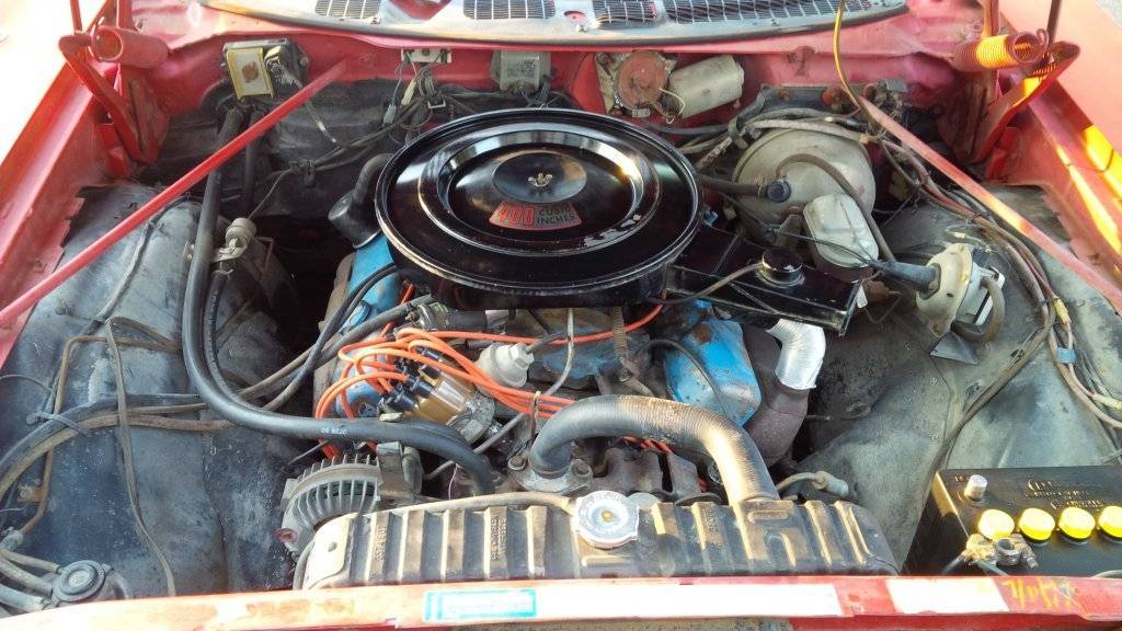

    Hello guys I thought I'd give you a quick update. I did a tune up consisting of NGK plugs, MP wires (sad they are still making two wires too short), NAPA Cap and Rotor with copper contacts (its vented, can't seem to find a non vented cap these days) and a new reman carb from Rock Auto.
    With the tuneup items installed it still wouldn't idle or really run properly. After installing the carb....she runs like a top. The carb was redone at a place called AutoLine...they are out of Winnipeg, Manitoba. I must have got a good guy redoing mine. Looked good out of the box.
    Anyway still quite a few things to tackle but its nice to have it running properly.

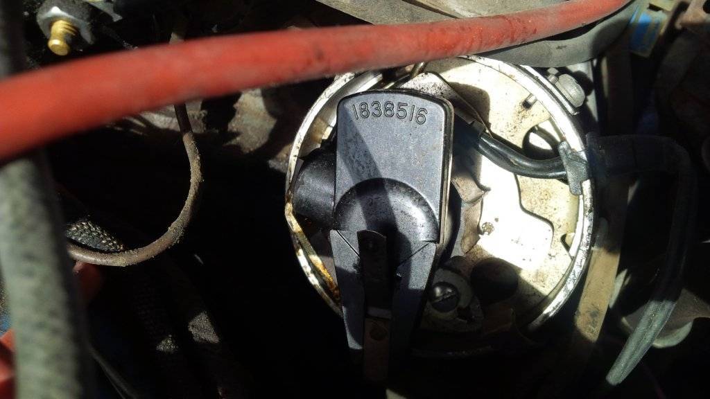

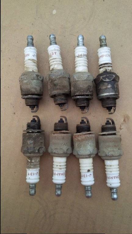

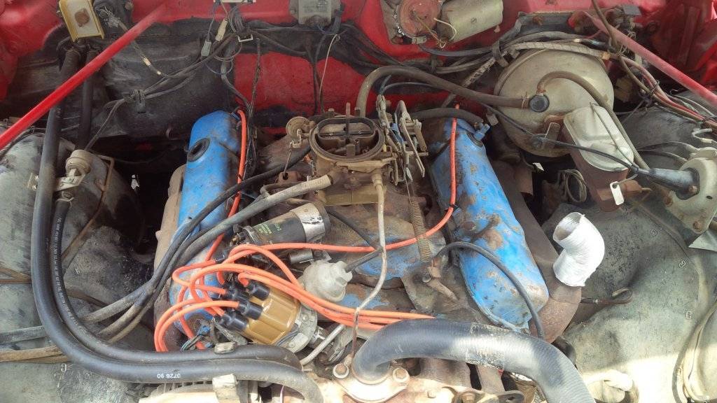

    I am pretty sure it had its original cap and rotor, along with 5 of 8 of its original plug wires and some old Champions.

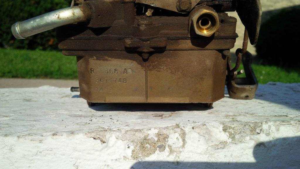

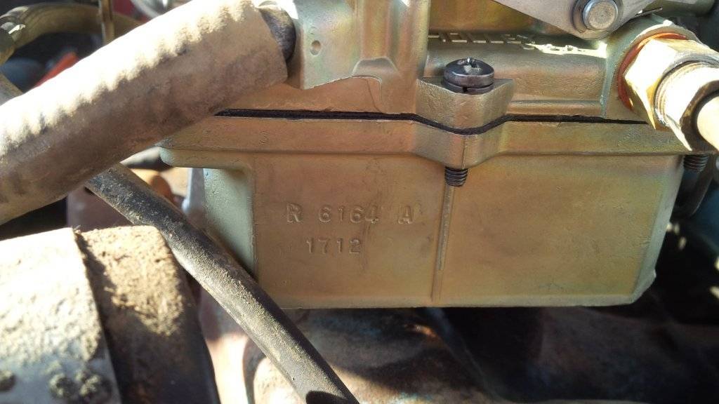

    Like anything it all boils down to the skills of the individuals working on it. I checked afterward and there are some good and bad reviews for AutoLine. I can tell you it the carb itself looked nice....although it wasn't originally installed on a Mopar it was dated pretty close to the original. The carb itself was $140 USD + a $30 core charge. So the price is good.
