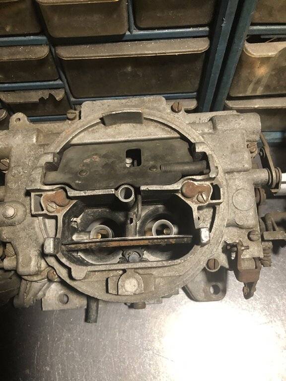

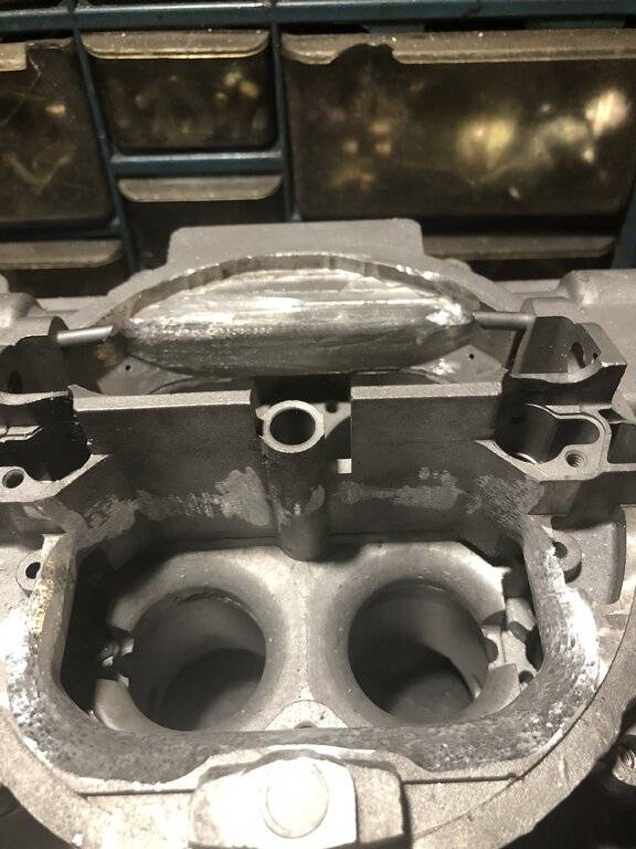

    Working with Wyatt to sneak some more CFM out of his AVS. He gave me the go ahead to carve on it. I’m gonna a little milling, blending, slabbing, smoothing, radiusing, thinning, and maybe a few more “ing” words to max out this thing. Here goes Wyatt it is disassembly day. Feel free to moderate pal. 587F6769-04E1-4C66-86C3-731330819419.jpeg A6830088-2CD6-4D33-853F-7B7C10CCD10A.jpeg image.jpg

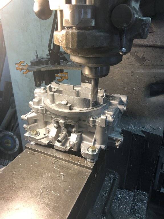

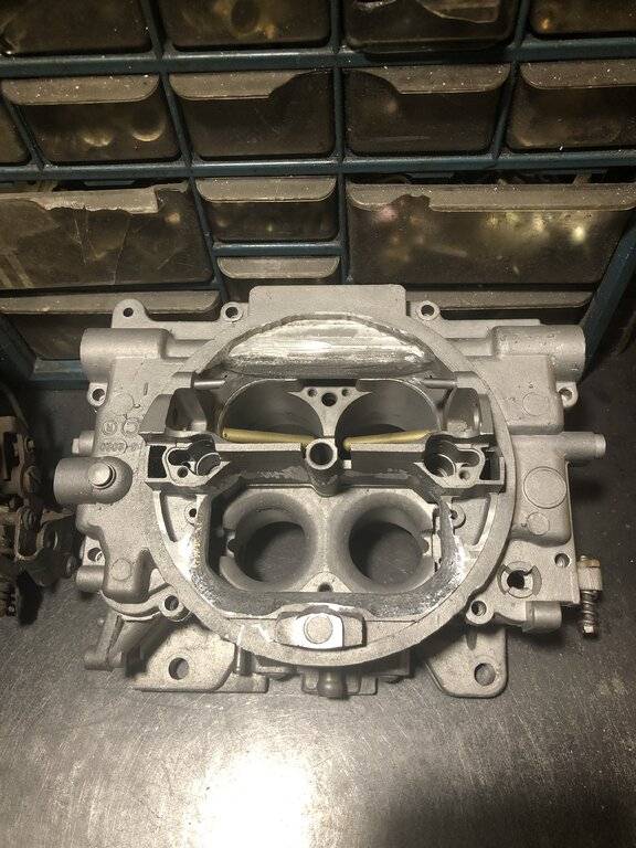

    Ok Wyatt, I had time to make a few chips today. Miller off the choke horn and roughed in the entry blend. And cleaned up some casting flash. DDF24A92-F0A6-47A6-A6A7-C44E2241D0AA.jpeg CA67247F-12C7-4304-9657-3C163D2C3615.jpeg 816F3267-F3D4-42B1-B6E4-C26E9EFD6465.jpeg 6092A9AF-B2BB-4B50-913C-A8435BEBC8A2.jpeg
