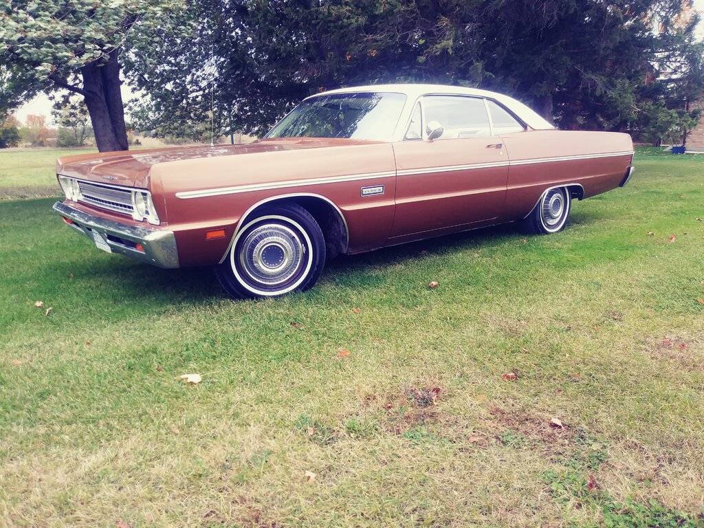

In general, I'd go with WW on a Newport, but then again with police wheels the RWL may make sense. I have BFG RWL on a 1970 Polara, staggered setup with 255 in the rear. Here is a pic.

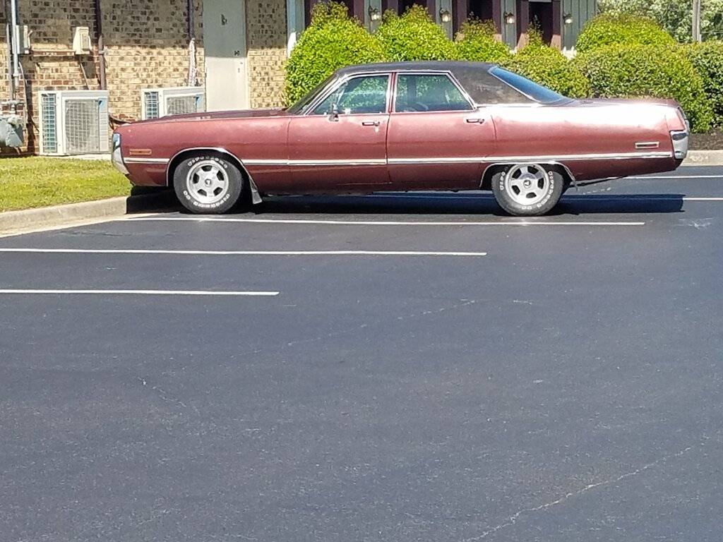

This is running the wheels that were on it when I got it, I've got a really nice set of black police wheels I was thinking of using.
Thank you for the photo! Is your car GK6 or GT8?
