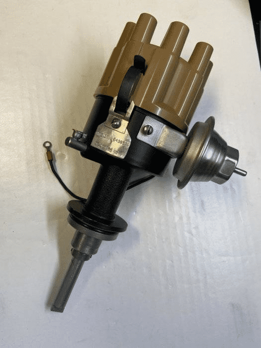

The engine should have a factory dual-point distributor with a cast iron body, as I recall. Specific point sets and a dwell-setting procedure with a few more steps than normal. Set the dwell first and then adjust the timing, in that order.

Dual points...."shudder"....I've replaced every points set up with petronix over the years. I guess I could re-learn how to set dwell - my timing light has the read out if I recall.
If it's the cast iron Prestolite dual point, it can be converted to the Pertronix unit, but it's pretty good in stock form with the points too. You won't be able to set the dwell with the car running like a GM though. The single point can be converted too for that matter, but don't be surprised if it's already been converted to a Chrysler electronic ignition, which is a good upgrade.
Easy to tell the difference.
Dual point has a black cast iron body.
Single point or Chrysler electronic has an aluminum body.
It should be noted that both of the distributors shown above are about 1970 vintage items as they have the o-ring lower seal. The earlier models, than them, use a thin stamped-steel beaded gasket under the flange. BOTH types go into the same hole in the block and work interchangeability, just that for the non-o-ring items, the flat gasket is needed to control oil or oil crankcase vapors which might escape from that part of the cyl block.
Looking at pictures, I'd say its the dual point cast iron - looks more brown than black, but when you figure age, etc. Either that or its the dirtiest aluminum I've ever seen.
If I buy the car - expect me to ask about this Chrysler electronic ignition - I like the idea of keeping it Chrysler. I'd also be open to keeping it stock, but points and I don't get a along, and if this thing has twice as many.....we're gonna need a bigger boat.....
