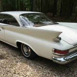

This is my '61 Chrysler Newport I'm in the process of redoing!!

Fast forward a few years and I'm in search of a replacement. I found this solid '61 outside of Houston Texas, made the deal and went to get it. It also has factory air with all components intact. Now to tear it apart and put it together again.
I have a low mileage 413 from a '59 Imperial that I want to put in it. I also have a 3 speed manual from a '62 Chrysler I want to convert it to. Trying to recapture my youth.
Problem is '62 tranny won't bolt to the pre '62 motor. They couldn't wait one more year to make the changeover. Oh well, I'll figure it out in due time. I've already requested info in the forum here. Hopefully somebody will give me a clue to a fix. I want to put a late crank in my 413 which will work. Anybody out there with a '64-72 413 or 440 crank they no longer need, give me a shout. It would be gratefully appreciated.

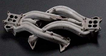

There are quite a few Ram Induction long 30" inside runners 2800rpm torque peak
and short 15" inside runners 3600rpm torque peak
intakes on eBay now in case you want that 413 to torque your head off...
Thanks for the info. Contemplating ram tubes. Have to solve the tranny swap issue first.
Pete, the tranny is coming out of a '62 300 non letter car. It's mated to a 383 presently.

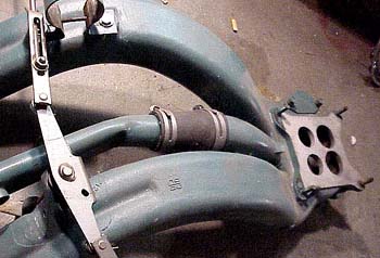

I bought a set of ram tubes, then discovered that was a small down payment on what it was going to cost to make that happen.
Fast forward a few months and I bought a complete '69 six pack set up, with an aluminum Eldebrock intake, including an air cleaner. Carbs being rebuilt as we speak. Sticker shock on the rebuild kit as it was about $200 for the kit to do all three carbs.
After I bought this set up, I was looking under the hood of my car, just glowing about how that set up was going to look on my 413. Then, after seeing how the A/C compressor sits on the front of the block, I'm wondering if that massive air cleaner is going to fit. Only time will tell. Anyone have any ideas on this problem? Hope it doesn't become one.
I'm planning to have the air cleaner top and valve covers powder coated in the gold color used on early Chrysler air cleaners. Then I want a graphics shop to make me a graphic of a lion to go on my version of a Golden Lion motor. Been googling photos of lions, looking for a candidate to create a caracture from like Plymouth's version of the cartoon Road Runner. Gotta come up with a catchy name for it, ie: Air Grabber, Coyote Duster, etc. I'm open to name suggestions from you witty guys on here. Some of your guy's posts crack me up. You're the ones I'm talking to. You know who you are.
