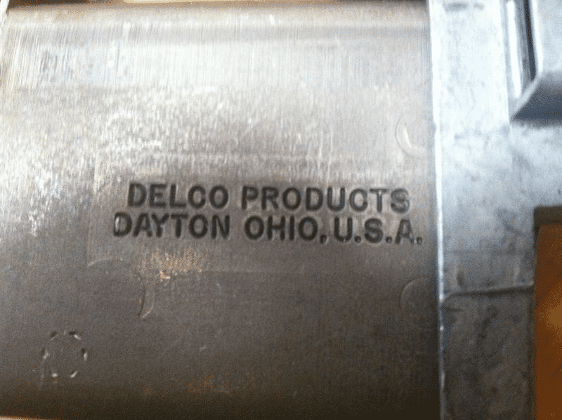

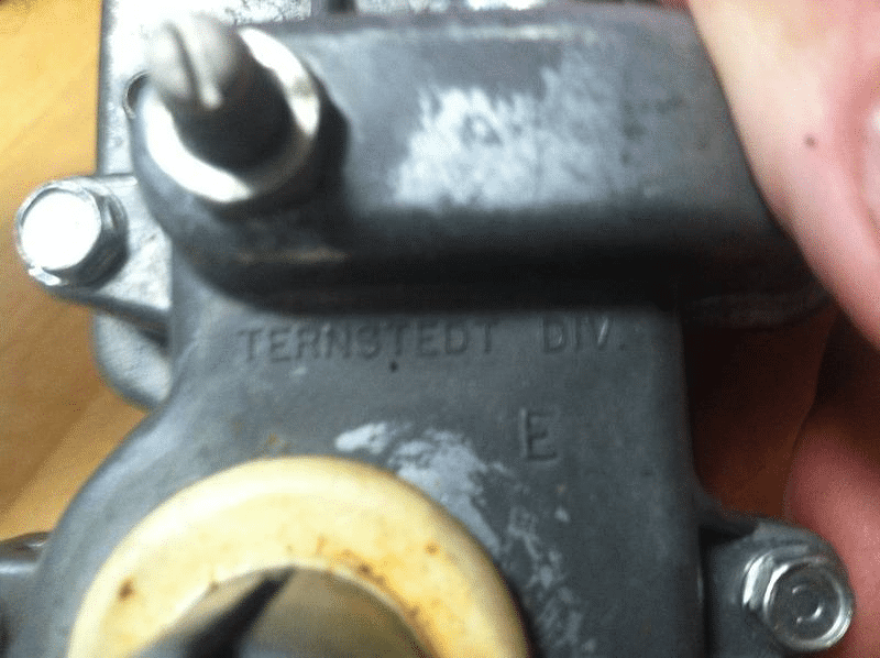

GM parts stamped as such?, used on Imperials too?

There are no brackets needed. They bolt directly to the door.
I have motors here.
