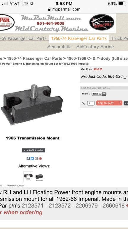

I got this car disassembled and don’t know what was there originally. But in a google search, I found a listing for 62-66 imperial mounts that looks like what I need. $700 seems like a bargain for the whole set, but all I need is the trans mount. What are you guys using?

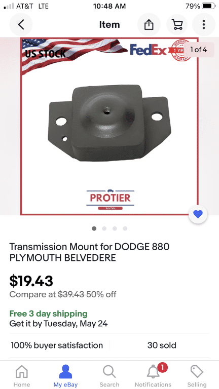

I ordered one for a Dodge 880, we’ll see how it fits. Looks like the center bolt is inline with the 2 outer bolts, and on mine the center is offset forward.
imperial services, steve charette has the correct mount. was $100 and 2-3 weeks wait about a year ago.
jim
Thanks, according to that site, it’s a one year only mount.

Turns out the earlier one I ordered had a wider bolt spacing and won’t fit.

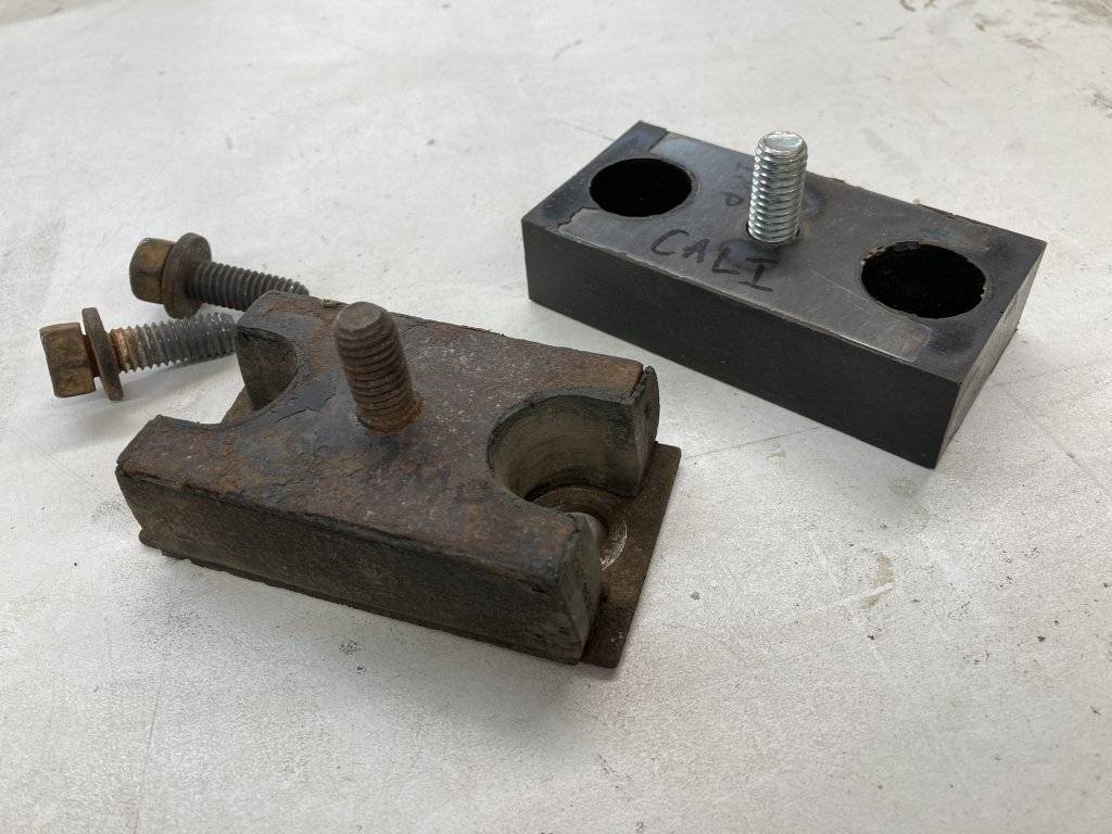

The center bolt in mine (also '66 Imp) is also offset forward about 1/4" in the position where it is resting. But it is quite obvious from the way the old rubber is distorted; it should be in line with the 2 outer holes as per Matt's pictures.
I checked the engine mount bolts (frame to mount) and confirmed the drivetrain is pushed forward as much as the clearance holes in the engine mounts allow. They seem to be a 1/2" bolt in a 3/4" hole.
What did you end up doing? Pushed the whole engine/trans assembly back to a neutral position for the trans mount?
I guess only shift linkage and drive shaft would be affected.
I am going to loosen the engine mounts and try to push back the engine and if that is not successful I might try an cast a soft polyurethane transmission mount with the center bolt offset.

I bought an original mount from detmatt. It's been over a year and my memory is fuzzy, but I think it dropped right in. I don't remember having to make any adjustments to install it.
Thanks - I guess I don't have to worry too much about casting the bolt and holes in line or offset then.
If I had lived in the same customs zone as any seller of a trans mount, I would have never even considered making one.
