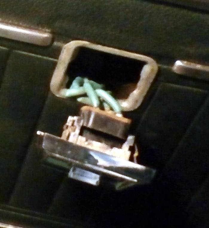

On my '70 Monaco, after I carefully disengage the power window switch from the metal surround in the door panel, I can remove the switch and plug-in carefully from the door panel and get enough room to carefully remove the electrical connector. The wiring comes in from an angle, not from directly behind the switch, so things happen good in that respect.

Here's what I'm dealing with regarding the rear-seat window switches:
I don't know how these connectors were originally mounted - they're too big to push through the metal trim frame. These probably came out of a Newport, don't know what years they would have been for, certainly '67 but maybe '66 through 68?

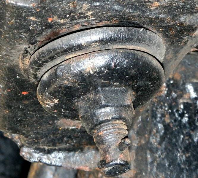

I've also ordered a new transmission mount. Something looks wrong with mine:

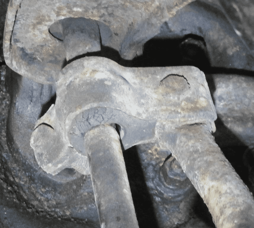

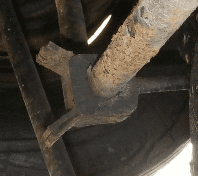

How do you exactly replace this sway-bar bushing?
And are these available?

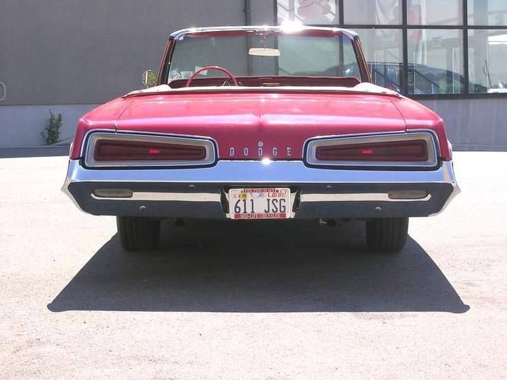

Per 67 Monaco/Polara taillights: it has been my understanding that Monaco carried This lens:
Where the polara carried this one:
There are however a lot of Monaco 500s I’ve seen that have these taillights. Being that either are stupid hard to find, I always assumed people went with whatever they could find.
I’ve got a Monaco 500 I’m working in and happened across a set from an abandoned sedan. The buckets were bad and the chrome was either toast or missing so I just combined the actual lens with what was good of mine … bout the best I can hope for.

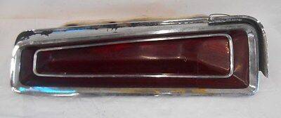

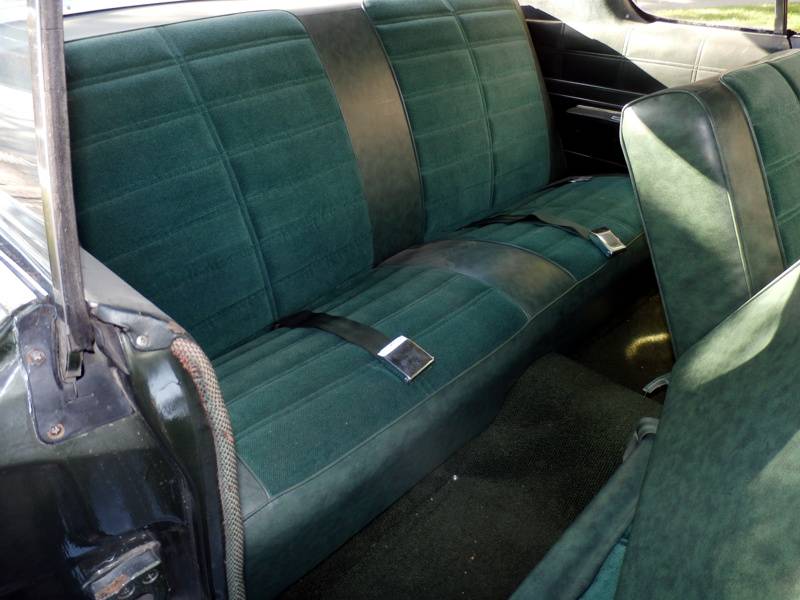

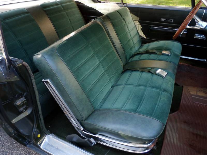

First, HWYCRZR that is an amazing and painstaking job on your seats. My original covers weren't in such bad shape, I got a set made locally (Windsor, Ont) based on the originals, and with the help of my mom (who took some upholstery courses to recover some of our furnature) we reassembled the seats with the new covers. This was in about 1987 (so 35 years ago). This is how they look today:
My seats had a combination of vinyl (or "leatherette") and fabric. The original fabric had more of a sheen than what was used here. This fabric has a velvet feel to it. But I remember the stretching and the hog clips. And welding a few broken springs.
Do you see the felt strip on the rear window? Where can I get that?

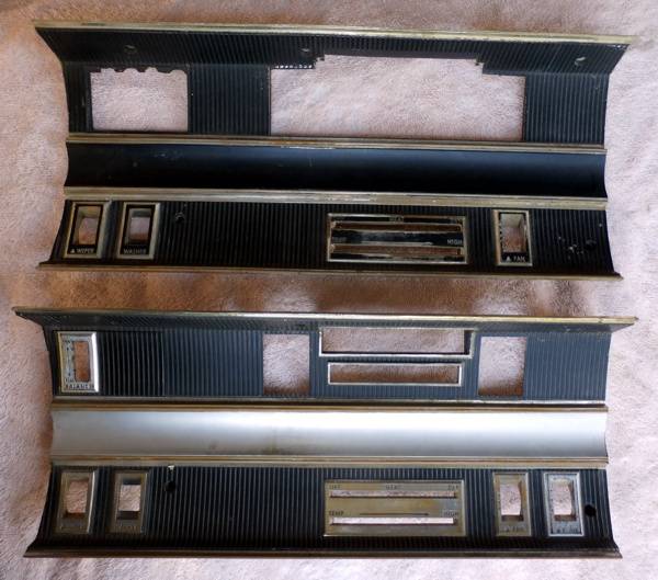

On to the random observations - the dashboard bezels and controls. Here's a photo of a couple of spare bezels I have:
Note that the top one has used more black paint (on the switches and center panel). I have a full dash set for this, but I don't know what car it came from. Possibly a Newport or New Yorker? Or maybe '68 Monaco / Polara? Note the different cut-out in the upper right (to the right of the radio). Normally what is there is a front/back fader dial. On the top bezel it looks like there was more there. Also the radio cut-out is different. Different radio? And no "R. Air" switch. I have the R. Air switch, but I'm a little fuzzy on what it does. This was obviously an option, but I'm not sure what it does.
Is it true that the '68 Polara / Monaco doesn't have the "flow through air" that the '67 does? (ie grill under the rear window) ?
The smaller dash panel (on the far left of the dashboard that has the headlight switch) - I've seen a version of it that has 3 switches across the top (instead of the usual single switch for the 4-way flasher). That panel also had a vent in the center, for A/C probably. What were the 2 extra switches for? (the car I saw this on was not a convertible).

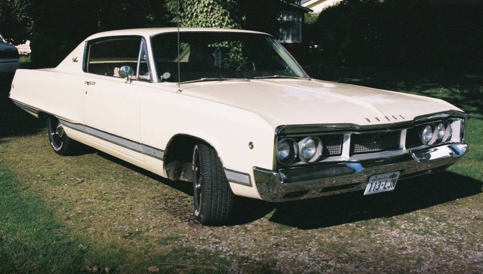

Lastly, I note that "MONACO" was sometimes spelled out on the trunk (with a stainless trim strip running under it on the lower edge) and sometimes it was just "DODGE" (with no trim strip). Was there any rhyme or reason for that?
Both are Polara/Monaco.
Top dash is ‘68. Non A/C.
Bottom with more silver accents is ‘67. In ‘68 they were starting to get concerned about glare. So you start seeing a reduction in shiny interior parts.
In ‘68 that changed to rubber. You can un crimp the bottom channel and slide it out. I replaced mine. I can’t recall the source as it was about 8 years ago.
Atlas obsolete parts? Maybe
Put the P/N in a google search followed by Mopar and it may turn up something. If you don’t have a Parts manual it is a great investment. Some are even free on Parts Manuals – MyMopar
