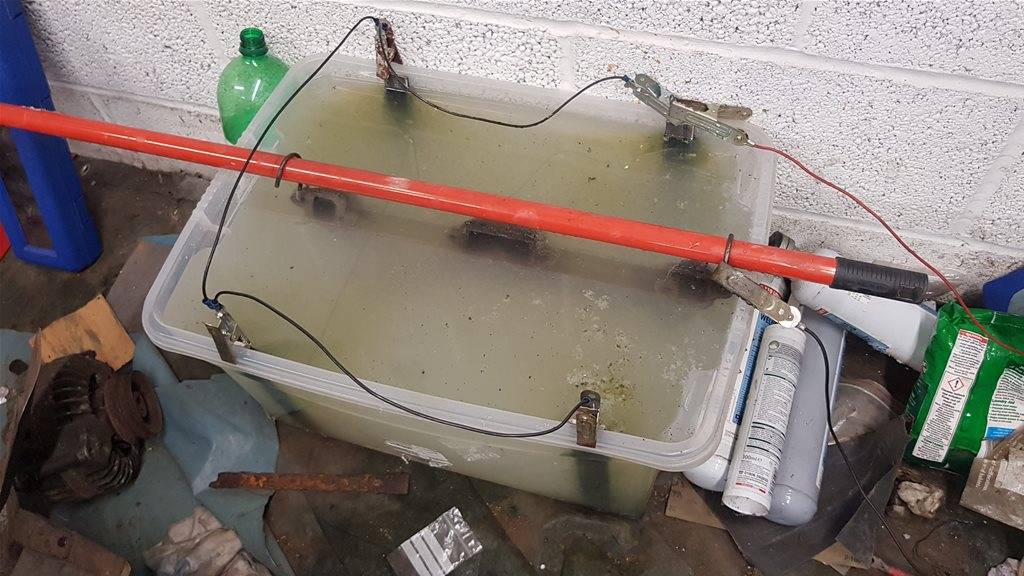

I've had to move up from the electrolysis bucket to something bigger:

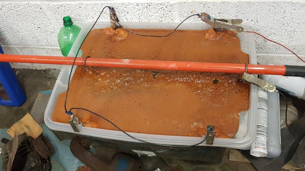

Not done any cast iron parts before (and don't worry that alternator is not in a queue for this treatment), but I'd say it's moved a fair amount of rust overnight:
From experience, the water above the part clears a bit when the rust has gone, so I'll leaving this one going for a while longer.

I would love to see an in depth write up on your electrolysis bath, chemicals used and such as rust is always an issue here on the east coast of America.
More info can be found on the web. Pretty simple to do and make. I use one on many of my small parts. Be careful on any soft metals like aluminum or copper as it will deteriorate them if left too long. I use it on cast/steel parts. Saves a ton of work and gets the part very clean. You should see the bubbling from the part if it is working correctly. Do this outside, not in a closed area where the gasses given off could ignite/explode. Not like a ton of the stuff, but suspect in a small closed off room/area that is where the danger could happen. Rust removal by electrolysis

I'd be happy to write a piece on the electrolytic rust removal process, but the page PontiacJim linked to in reply #129 does a pretty good job of explaining how it works. I'd add that:
1) Only use ordinary steel or your solution ends up containing heavy metal pollutants.
2) Modern battery chargers, in Europe at least, have to 'sense' a battery before they start putting out a current, so you're probably better off using an older charger or if you don't have a power supply, you can just use a 12v car battery.
So here's the first manifold after it came out of the bath:
Looks a bit browner that it does in real life. I was very 'dusty' - haven't seen this before, might be a cast iron thing. I hit it with a wire brush and compressed air, then some Simonez UHT black paint. After drying overnight, it went (don't tell anyone) into the oven for 90 minutes:
