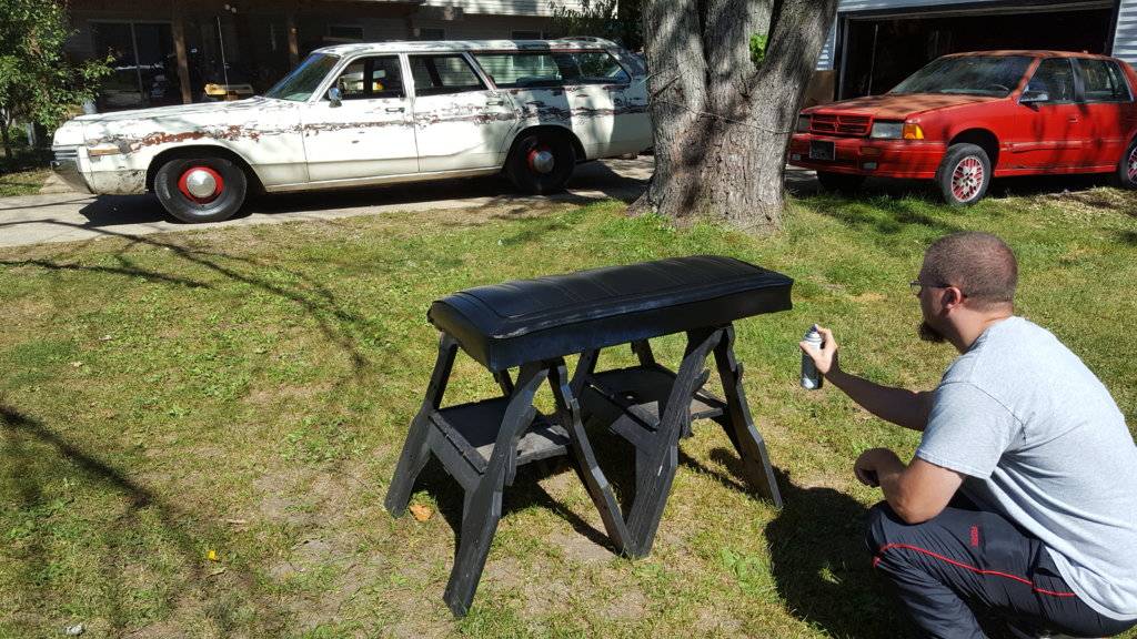

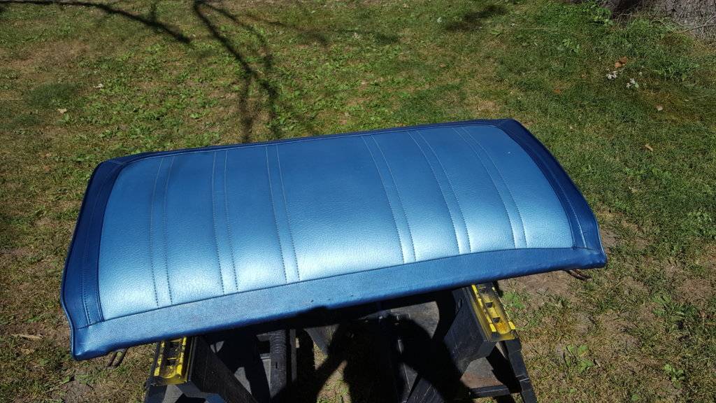

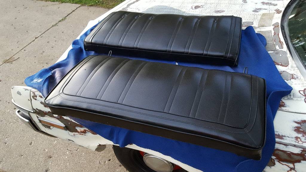

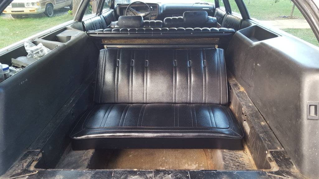

Not sure if I've mentioned it but this wagon came from the factory as a 6 passenger. My younger daughters have have been excited about the thought of riding in a rear facing back seat. Fortunately this summer at the Volo gathering, Mike (Wonderwagon) was nice enough to sell the 3rd row seat out of his parts wagon. So yesterday my oldest son and I spent some time tearing it down and changing the color. Not finished yet, but the rattle can vinyl dye turned out pretty good. Here's a couple pictures so far.

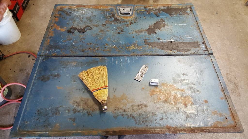

Geeze, the glue they used on the backing boards is some tough stuff...can't even imagine the work it takes to scrape the coating off the underside of a floorpan with a torch and a putty knife!
Looks great Manny, you did a very nice job! Will need to do the same thing to my blue wagon, once I get some better pieces.

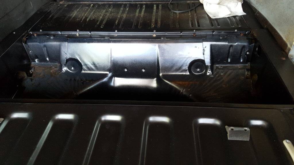

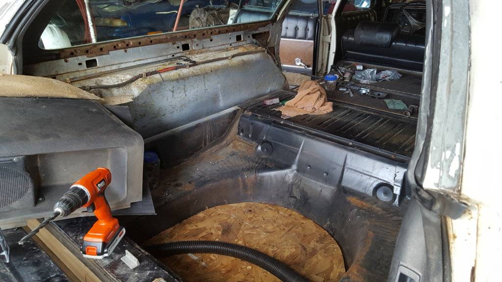

A couple more pictures. Getting ready to drill holes in the floor to mount the seat brackets. Nice to see the factory put dimples exactly where they need to go.

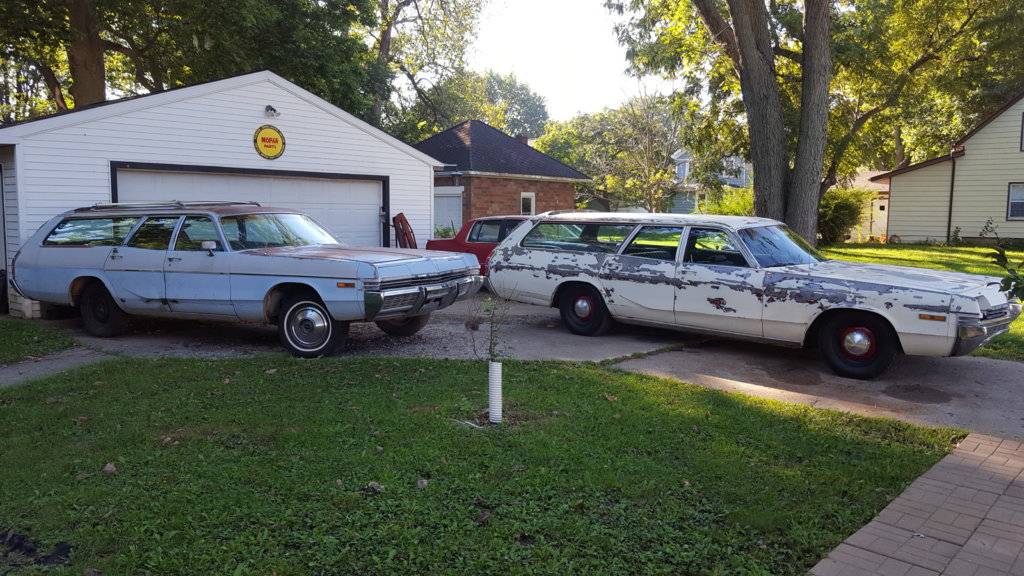

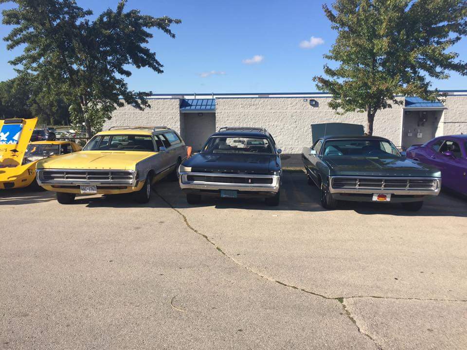

I love the top picture where you can see the two wagons side by side. That's a really uncommon sight these days.
The seat came out great. This will be a good test of the durability of the vinyl paint, with kids bouncing and sliding around on it.

Thanks Jeff for the compliments. Manny above is really the person to talk to about pictures of two wagons together!
But here's another shot with the blue one included. Originally the plan was to use it as a parts vehicle if the need arose. But after it was shipped from Utah and I was able to inspect it in person, it's way to clean for that.
And yes I agree, we are going to test it out on the kids clothes first haha!

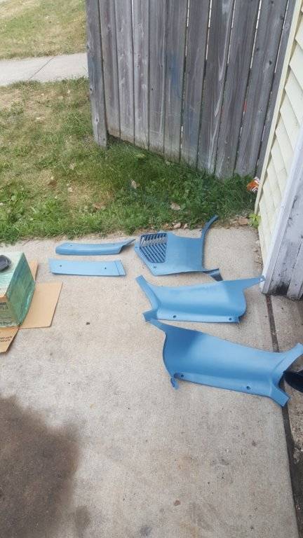

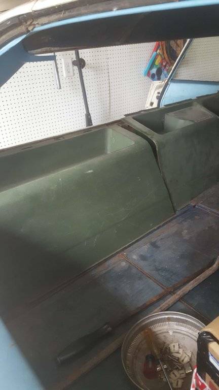

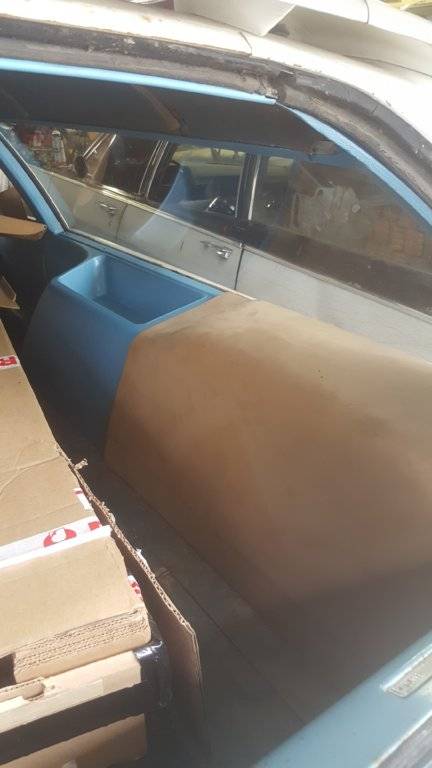

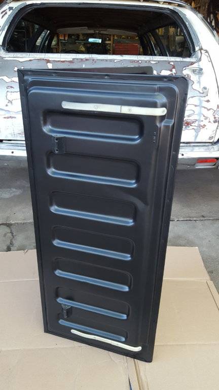

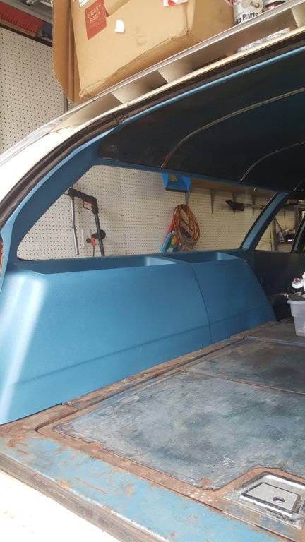

Those panels look great! :wideyed:
Inquiring minds would love to know what they looked like before, and what you did to make them look like new.
Jeff
Jeff
Thanks Jeff i got the big panels from @saforwardlook the little one's i bought from a different guy. I cleaned them up really good and used a old school parts store that had a paint shop in it. They took the kick panel and matched the color pretty good to me 25 buck's a can.

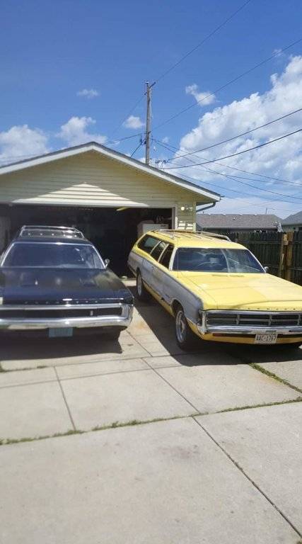

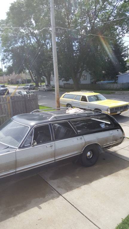

Here you go Jeff couple pics of the wagons and my buddies 71 GT.
Thanks! Awesome cars! Two very unusual colors for a wagon on top of that. Do you have any plans to restore them? On the one hand it would be nice to see that done, but on the other hand you'll get more use and probably more enjoyment leaving them as drivers.

I've been tinkering with both of them on and off the black 70s 440 is done at the machine shop it's bored has Keith black pistons ARP head bolts new freeze plugs. Also got new cam bearings and a 507 cam getting a double roller timing chain. I wanna get the drivetrain all good in the black one so then i have time to cruise in it and do more body work. While working on the 69 and my dads 71.

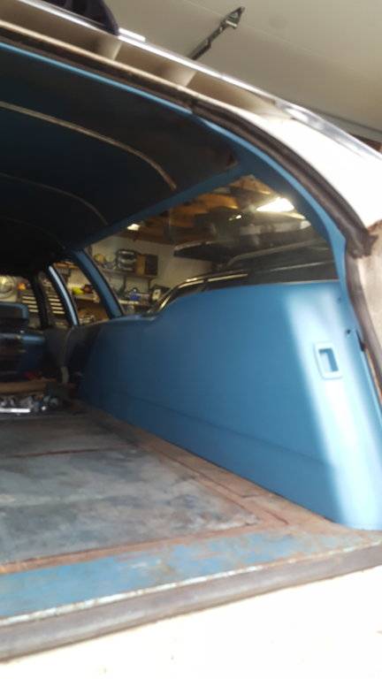

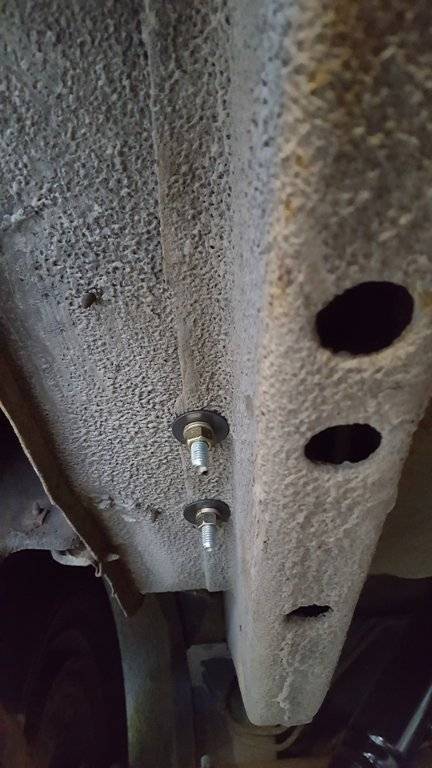

Well after getting the seat frame painted and comparing it to the interior, things snowballed after it was obvious the panels needed to come out and be cleaned up. Was a good thing as it enabled me to take care of a couple "nests" hidden underneath. Tossed the idea around in my head to repaint the floor, but it's more than likely going have carpet put over it so I just wiped it down. My trusty camera shy partner even helped hold the bracket bolts in place while I was underneath.
Forgot to drill the seat belt attachment points, so that's next. Should have it buttoned up today provided I'm not pulled away for something else.

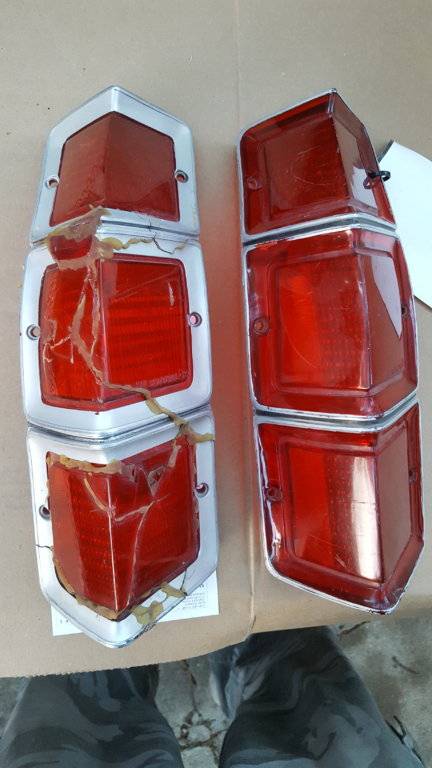

Hello again David! Off the top of my head, I think I'm good at the moment. Unless you happen upon either side tail-light for a 72-73 Monaco/Polara wagon at a fair price. I picked this one up on eBay for $50 shipped. Thank you very much for asking Sir!
