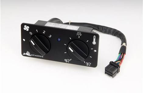

Pictures won’t show anything on the Ac. There are 2 switches hidden in the glove box along with the temperature control knob. One switch is for the fan and one for the Ac compressor. When the car comes back for its 1,000 mile checkup the fan switch will be replaced with a variable speed switch.
The dash controls still operate the defrost, dash, and floor doors. It’s all simple to do, will get your Ac/heat operational and there is no need to remove any of the dash.

Play by Play:
1. Run fused wire to an aftermarket variable blower switch then directly to blower motor.
2. Run fused wire to an aftermarket on/off toggle switch to compressor.

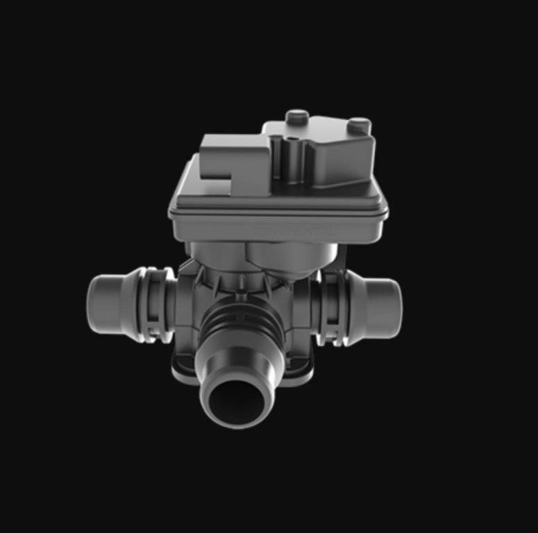

3. Run fused wired to an aftermarket 12V variable switch and then to 12V variable coolant valve.
Bundle all the switches in gobs of duct tape and stuff it in the glove compartment.
