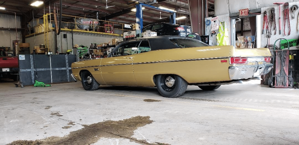

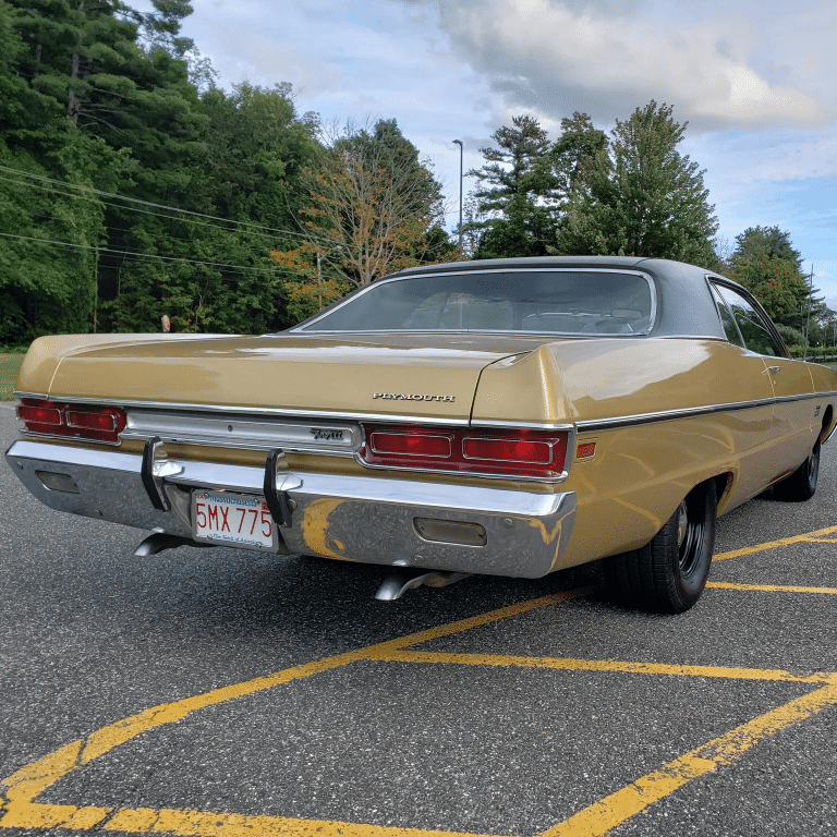

My 69 Fury III had a tired 440 low compression engine so I went to a stroked 440 to 505 . Nothing fancy compression wise and the "Big Boned Gal" as I call her will eat absolutely any type gas offered on the street , any time , anywhere and put out gobs of torque easily, and will want more.....gas. I fricken love it. She doesn't have to race anybody and no one has seen anything like her ever or in 40 years if old enough.
God I love the 29 roof
