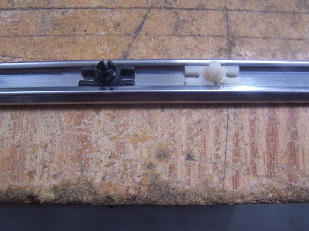

I’ve got a full set of outer aluminum belt line trim pieces, but lack the clips. Has anyone found a source for the clips or a good alternative? First picture shows the trim piece I’m talking about just to be clear. The second picture is of a solution I thought I had. Auveco 807 clips fit the trim just fine, but they’re too long. There’s a ledge under the trim attach holes in the body that won’t allow for anything that penetrates too deeply and these are way too long.

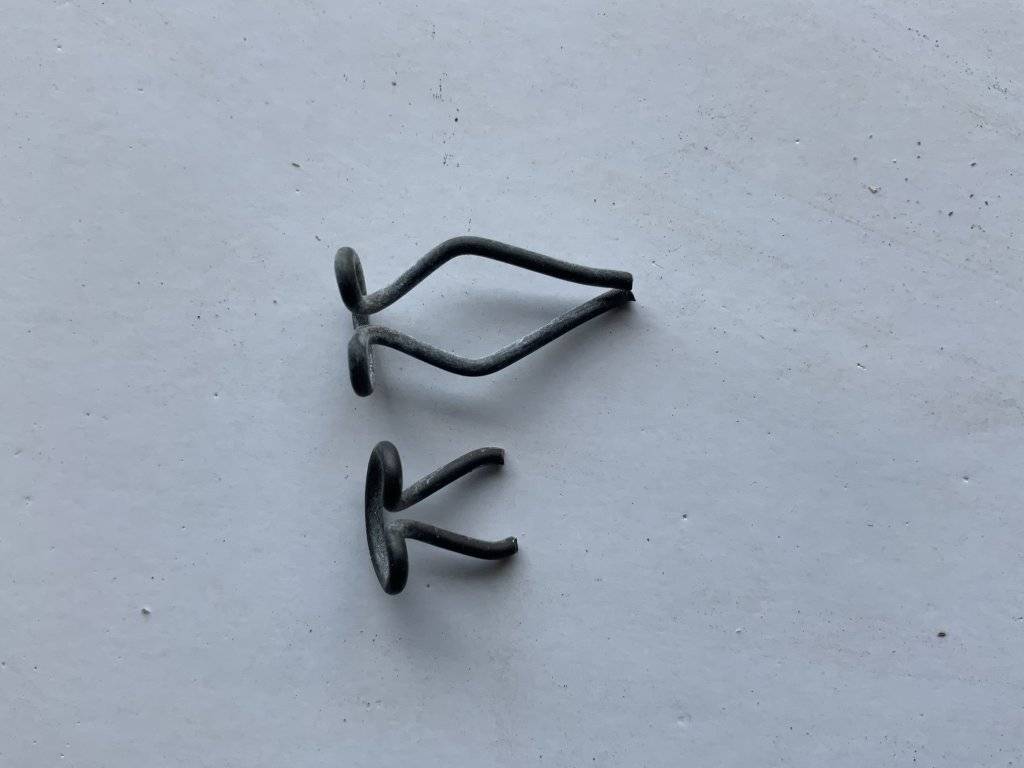

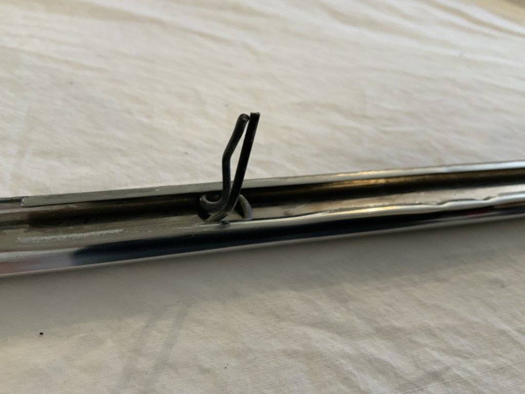

Here’s another thing I tried that didn’t satisfy me it would work well. I had a bunch of the 807 that started this post. Problem was they were too long (and also stiffer than needed for a piece of trim this light). You can see from the attached I tried cutting them shorter. Two problems were that you would have to reach in to squeeze them down with a needle nose to get them started and they didn’t spread wide enough to suck down the trim as tight as I would have liked. I discovered this by inserting one w/o the trim piece. I think they could work if they weren’t just too darn stiff to reshape a bit.

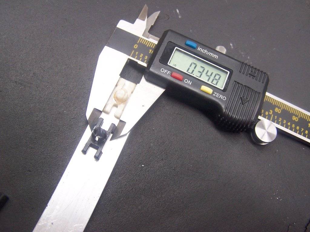

I received some clips that I was able to make work. They measure the same as the factory clips pn: 6001 496.
These clips are the closest I have found to the originals but are black in color and they have the correct pegs that fit the 3/16" holes. I have done a lot of research on this and found that there was some reference to the pn: 6001496 clip included in a E body tail panel kit but they are not correct.
These Volkswagon and BMW clips match up real well but they are very tight fitting and take some ingenuity to finesse the molding on. The best luck I had was to mount the clips in the holes. Then smear some hand cleaner (goop) on them. Then kinda roll the molding on from the outside-in. I used small hammer and piece of wood to tap the molding down onto the clips. You have to be very careful not to ding up the stainless. There may be a better way someone can come up with. Possibly shaving the clips down just a hair since they don't have much give. Here are a couple pics. and a link to the clips I bought. The white clip is an original and the black one is a new one. Good Luck guys.
