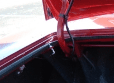

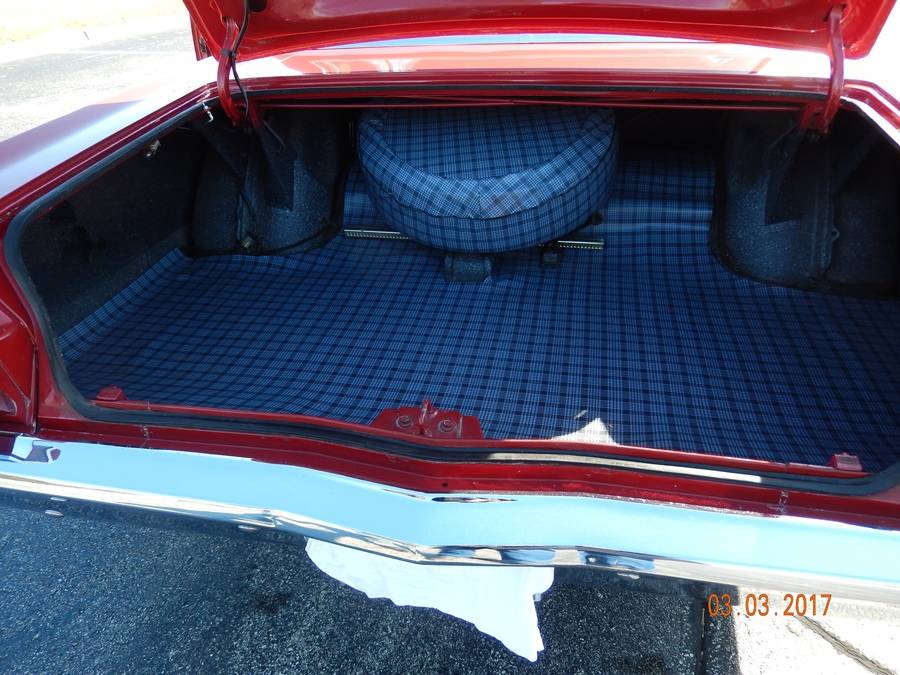

The "switch" is basically the same type of switch mechanism that is used for the door jams. The trunk lid holds the circuit open when in the closed position. This light is always "hot" - ie has power. If not adjusted correctly, your light can be on when the lid is closed and drain your battery. Below is a photo of my 67 Fury. Note, there is not a reflector on the bulb. I had mine "for show" and could use it. I put an insulation material at the base of the bulb as not to have a battery drain down.
cool! Mine closes correctly and turns the light off, but doesn't "pop up" and turn the light on when you open the trunk, so I'm guessing what ever spring mechanism is "inside" the switch has failed. I might try to craft some little light deflector/reflector out of foil just to direct light down instead of up.
There is an internal spring in that switch to pop the center section upward with the trunk lid open a bit to turn on the light.
