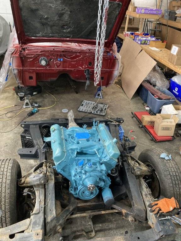

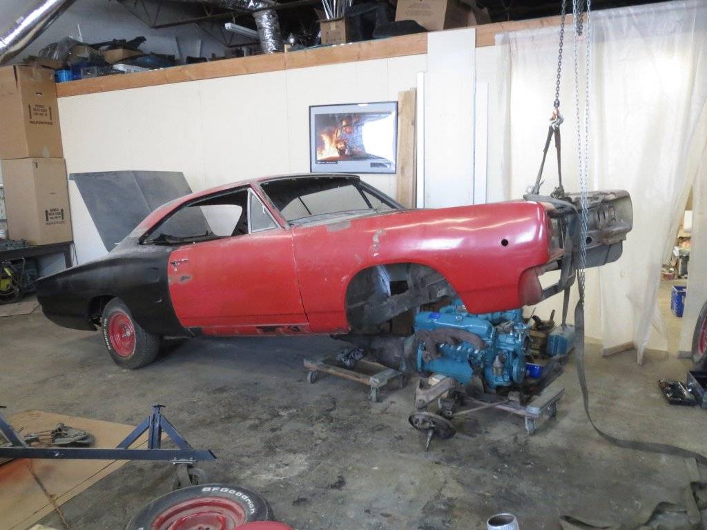

sorry to get a little off topic and this might be a dumb question but thats never stopped me before.. whats a typical reason to remove the stub anyway? other than a different way to remove the engine/trans why would someone do that? also how would you align it correctly when installing it?I found it very easy to unbolt the stub and roll it away from the car with the engine and trans still on it. It works even better when putting putting it back together.
I am changing the stub frame on my '67 Fury III 4 door hardtop and when I remove the 318 engine, I'd like to remove the engine with the 727 transmission together. I have removed these engines before but unbolted from the transmission and using a lifting pad bolted to the 4 carb studs on the intake manifold with no problem. Is it safe to do it this way with the added weight of the transmission or not? I appreciate any help and info here as always. Thanks.

. 1st engine pull was a seized 318 in my driveway, teepee tripod made from three wooden poles lashed together, and come along.

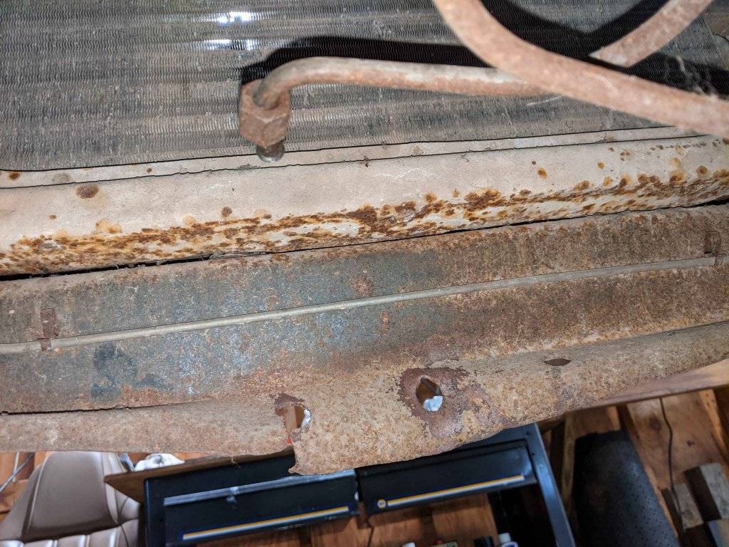

My stubb frame was pretty crispy as were the mounting points on the unibody so mine had to come out and I wouldn’t suggest removing it just to make getting the engine/trans in and out easier.sorry to get a little off topic and this might be a dumb question but thats never stopped me before.. whats a typical reason to remove the stub anyway? other than a different way to remove the engine/trans why would someone do that? also how would you align it correctly when installing it?
