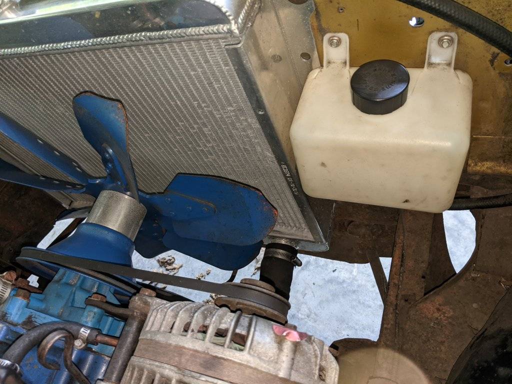

I used generic from Advance Auto. No special cap. Not pressurized. Hose connection at bottom of reservoir.
