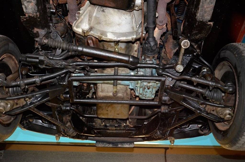

Zee-wiz, you have to show us the complete article! A Ferguson four-wheel system?
(It worked on Jensen FF, which all had a Mopar BB, so why not on a C-body?)

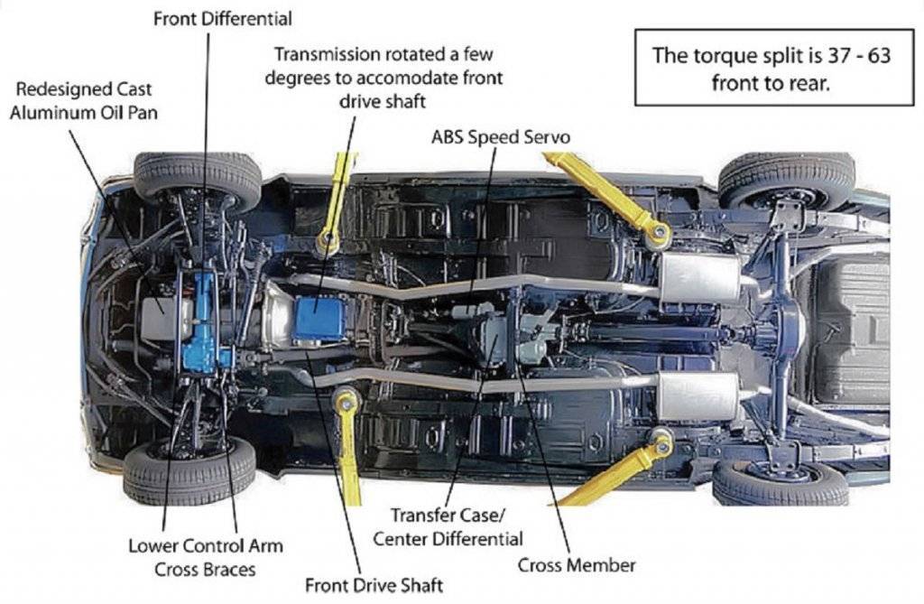

did a search on his name and got to pics of a 65 mustang that he had done an all wheel drive to , and the transfer case is used in those awd race trucks .
So, it could be done: take a rusted-out old Jensen FF, transplant the necessary organs, and voila: you have a 4wd C-body. (Finding the donor will prove to be the hardest part.)
