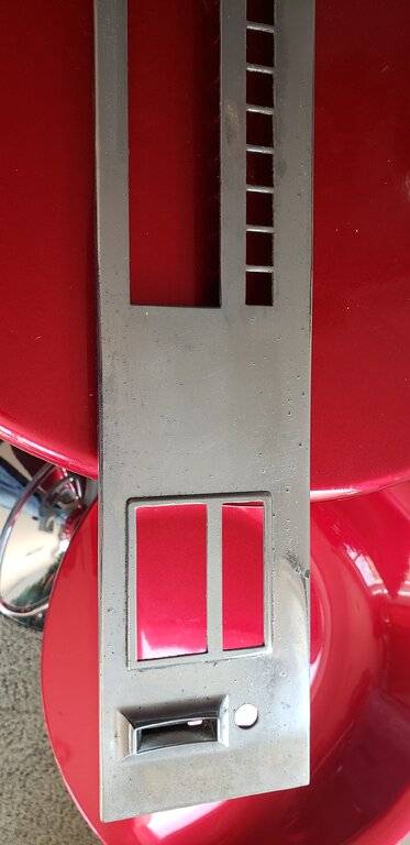

Here is the first piece I am going to work on. It is nice and flat except for the coin slot. I have already sanded it down.

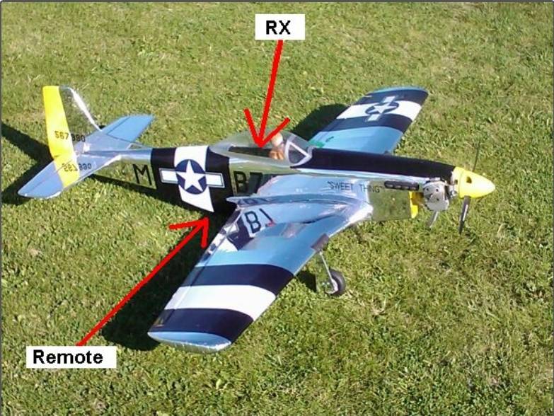

Since this is for something which won't be exposed to outdoor weather, another option may be to use the plastic film that's used for model airplane wings and fuselages. I remember a couple brand names were Ultracote an Monokote, and they are available in shiny chrome. It's a shrink wrap with heat-activated adhesive on the backside.

Got home and checked it out. I found this plane covered in the Monokote product. Pretty impressive mirror finish. I have the same type of iron which I use for woodworking and have a great industrial heat gun, so I have all the tools required. The product is only $15. I will definitely give it a shot.

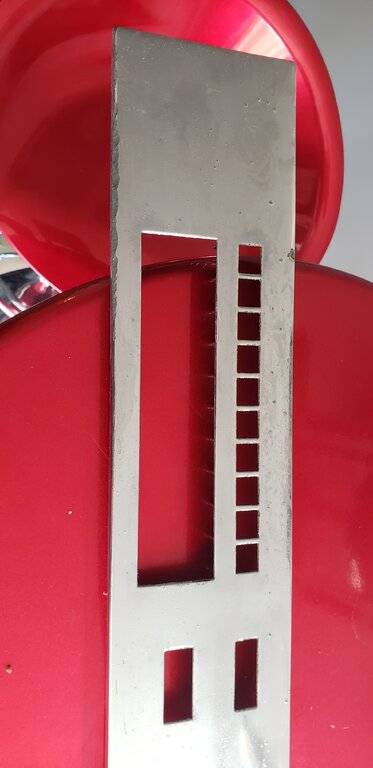

One positive out of this I discovered the better prepared and smooth the surface, the better the chrome paint looks, which quite honestly looks better than the chrome vinyl wrap.
For anyone interested I am using a Krylon filler primer after I throughly sanded the surface first. The chrome paint is Rustoleum Metallica finish. I plan to clear it, to hopefully extend the life of the finish.
