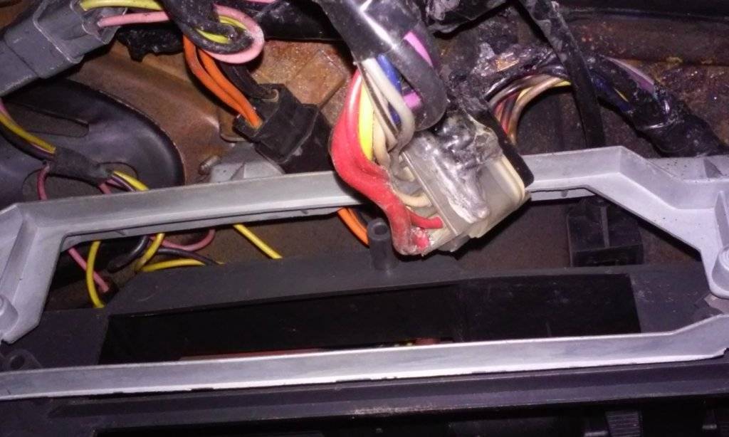

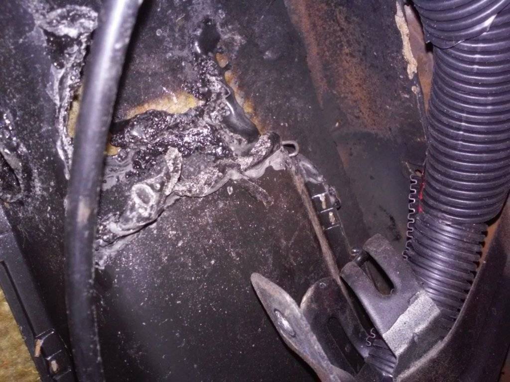

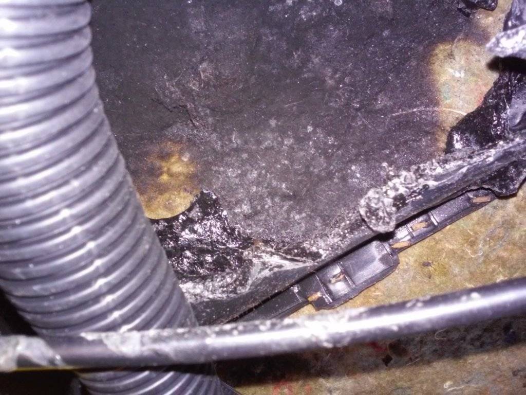

Last thanksgiving I parked it in the driveway. I got out and thought I smelled something burning. I thought to myself what could that be? I turned my head back around and saw a mind freezing sight: flames coming out of the left defog vent. Pics:

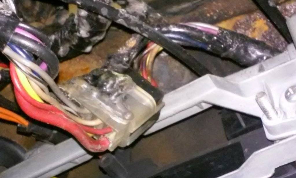

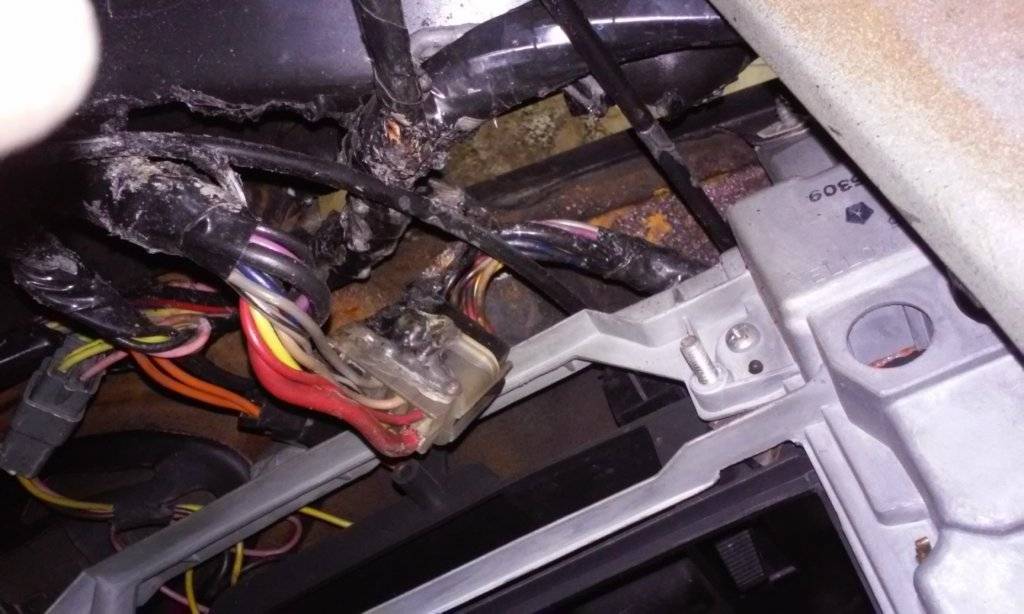

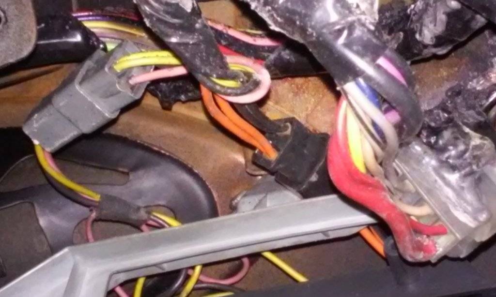

This was the ignition source: the connector. It melted during the fire; but I think it was melting within, enough so that two wires could come into contact with each other (I have pics of that). Its funny because I think this could have been avoided (well, not really funny)...I kept hearing a noise that sounded like a turn signal relay EVERY time I turned the ignition key to start. Sometimes, the car wouldn't start...the starter motor wouldn't engage. There some other issues going on within the ignition system that were more pressing so I worked on solving them (and I did). However this one little issue would keep rearing its head. It kept this up for about two years (the weird noise) all the while I was dealing with the other stuff.

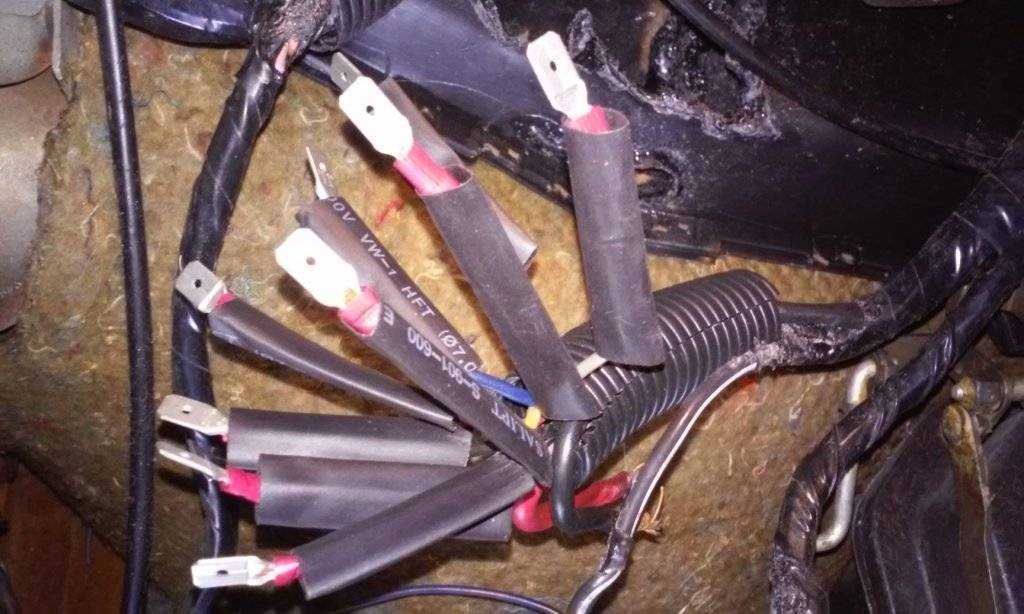

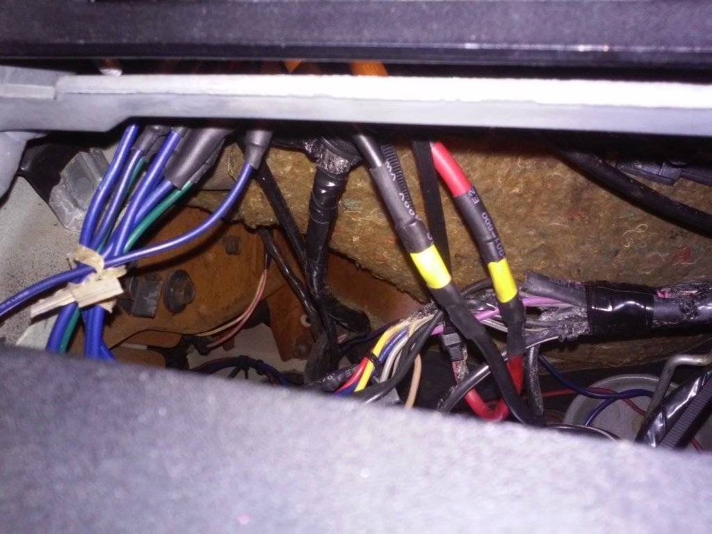

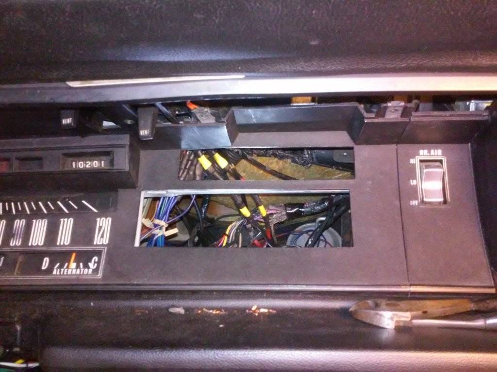

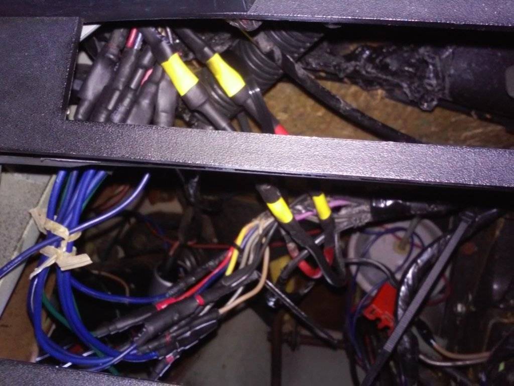

So...I cut out the fried connector, and any other fried wiring...all I could find. Luckily it looks worse than it really was. All I really had to do was removed the burnt connector and replace it with another one OR just match and connect the wires together, which is what I did. If figured the connector was just that, a connector. It was connecting wires. I pulled it out, examined it real good. It was a connector.

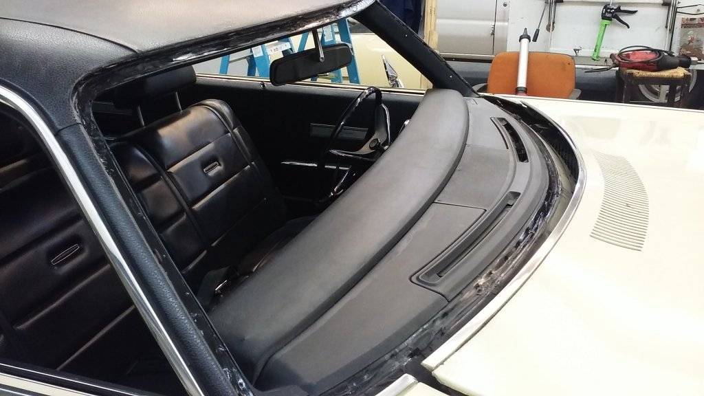

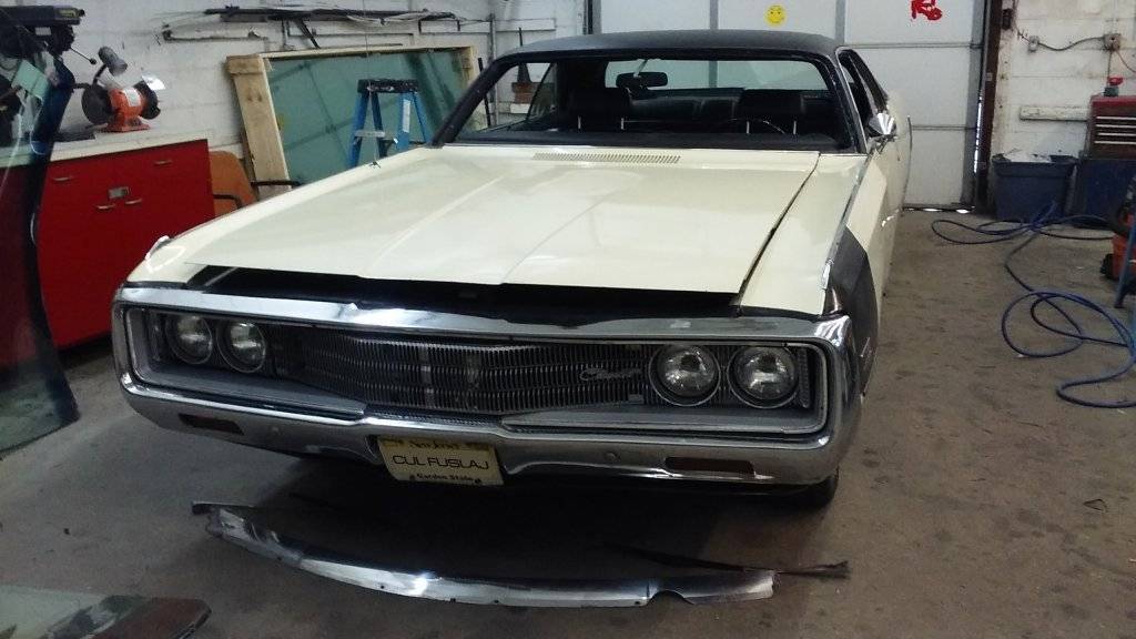

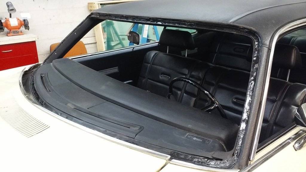

Unfortunately the flames from the fire cracked and destroyed the windshield....and I had to source a new one that was exactly like the old one...I didn't want quick slap in glass that didn't match what the car was born with; tinted w/double tint along the
top.

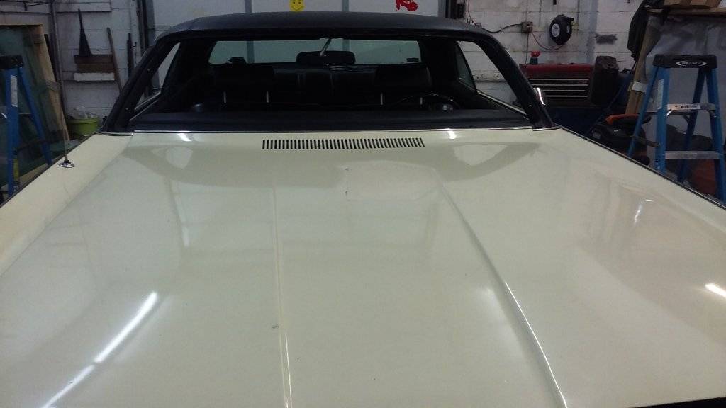

What happened to the left Fender btw., Looks to be in partial primer.
Yeah...whilst it was still in dry dock and I had the front of the motor torn down I toyed with painting the car right there where it was parked.

I disconnected my ammeter or "bypassed it". I kept hearing horror stories about that and finally decided I wasn't gonna wait for it to happen to my car...cause instead its gonna happen elsewhere. ; (
Did you bypass it before or after the fire?
Before...way before.
That's interesting. It looks to me like the fire started at the connection for the large black wire. That would be the wire coming from the ammeter.
I'm not saying that bypassing the ammeter was the cause. I have never agreed with the theory about ammeter fires though and still don't. I am really thinking that there's been a lot written and said about the connections at the firewall and not much about the other high current connections like this one.
Yeah I agree Big John it looks like that's where the fire started. Half of the connector was completely melted and I couldn't pull it apart. As you probably know the ammeter bypass thing is at the MAD website. I understand what they are saying (mostly) so I bypassed it and using a voltmeter now....more out of fear than anything else I suppose. and yet, it still made no difference..lol.
