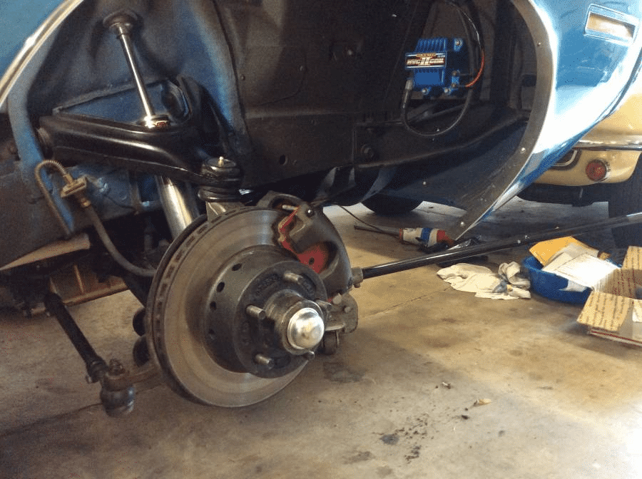

All done and ready to roll.
That hose looks like it's taut at the fitting, likely is at the caliper also.
You might want to check that hose with the wheels at full turning locations, it likely gets worse.
It's been my assessment (and I've seen some others say it also) that the hose/tubing bracket needs to be rotated a bit to ease the routing of the hose when swapping to discs.
You can probably bend at the tubing and drill a new hole for the anti-rotation tang on the bracket - disconnecting lines might be avoidable.
^This^
With some cars, you can flip the brackets side to side and mount the caliper towards the front like this one:
The new hoses were not yet on when the pics were taken but everything is fresh now included the wheel bearings.
At the risk of sounding like an *** - are the new hoses longer than what is in the pics?
(if it wasn't your brakes I wouldn't be asking)
They sure are, my buddy is very thorough in everythinghe does. He actually works on Mopars as a living and has been for 45 years now. Buys and sells, restores and builds them, mostly A, B and E bodies tho. The whole underside of the car is basically new; brakes, bearings, suspension etc. He is even swapping the original mufflers for a set of Turbos so the sound will be right too
Cool.
Can you post the part# of the longer hoses? That might be helpful for future surfers that read this.
Too short. You need a longer one. Check it when you turn the wheels, and it must be just enought to not a hard bend.
