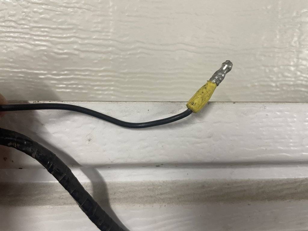

I have problems with electronics in my 71 Plymouth Fury III. The turn signal indicators are shines continuously. The fuel gauge doesn't work.

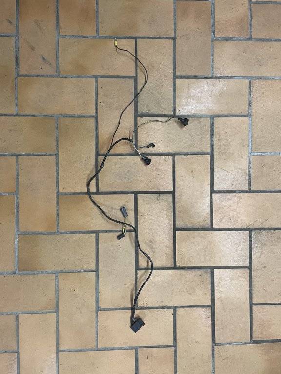

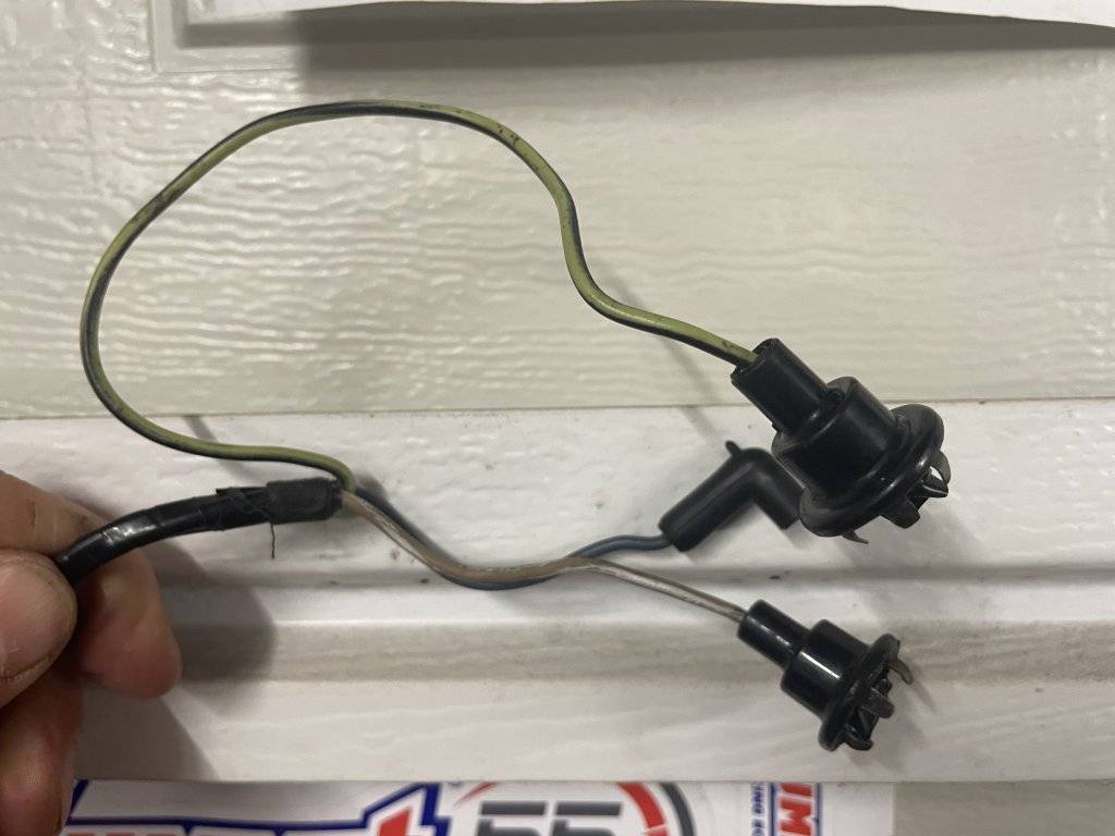

Today I also took the dashboard apart. I noticed a cable that made me suspicious. The Fury was once retrofitted with hidden lights. But these were then dismantled again.
The Fury is currently with the original front and lighting.
Do you need different wiring for the hidden lights?
I found this cable.
What are "hidden lights"? What did their wires attach to in your harness? Have you downloaded a FSM from www.mymopar.com? Looked at the wiring schematics in it?
In the schematic, look for "common feed" circuits ("Common" does not mean "ground"), where one circuit is the feed for several functions, where those feed circuits are attached to items with "variable grounds" (for gauges and such). If the turn signal indicators are always "on", with the light switch "off", it could well be that a "ground" is not where it needs to be, so the electricity has found the easiest place it can "get to ground" for a complete circuit.
The fuel sending unit grounds to the fuel tank line with a special clamp at the tank, which touches the fuel sender itself and the fuel line coming from the tank and going to the fuel pump. Check that before buying anything! The FSM should have a picture of it, too.

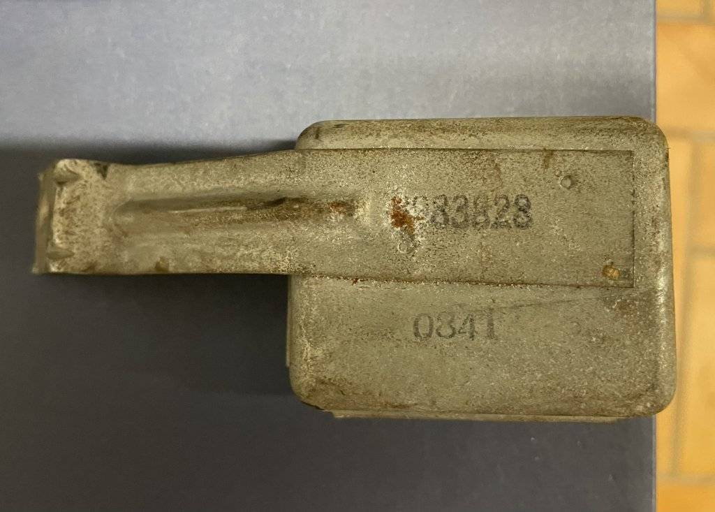

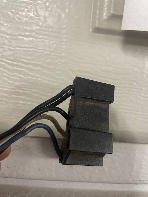

I found out that the cable connects the fuel warning relay and the lighting. So it has nothing to do with the hidden lights.
I will send the relay to a friend who will check and repair such parts. Can the flashing indicators indicate that the relay is defective?
The low fuel relay would have nothing to do with flashing indicators.

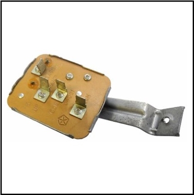

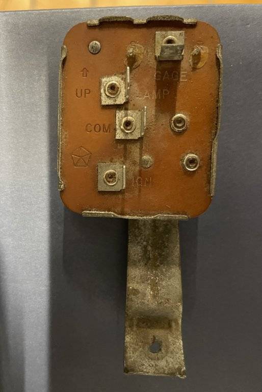

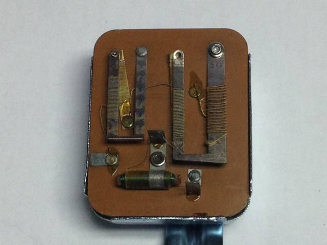

Inside it, there is the voltage limiter for the fuel gauge and the relay that lights the low fuel warning. It's an expensive piece to find as it was used in some E-Bodies and a bit rare.
The coil in the right side is the limiter and the left side is the relay.
