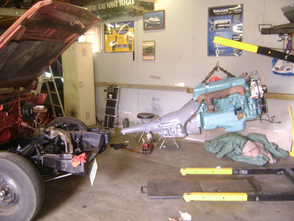

You don't have to pull the front clip like I did.
