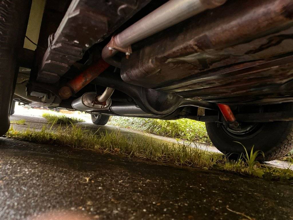

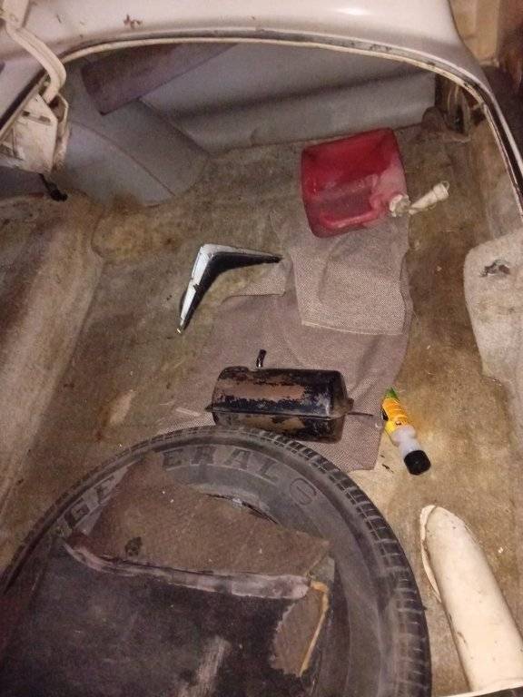

From the poor photo's, it seems to be a solid car, but I have not seen anything from underneath.
I think this could be the one, but I am very keen to hear what you guys think.
I think the car looks like it's worth the price.
However, you need a test drive to determine engine/trans and rear end condition.
Have them put the car on a lift and look under it. Floor pan rust could be a problem.
Nice find!
Thanks for the input!
There is no lift available, but I will bring my jack so I can inspect the flooring. Good tip!

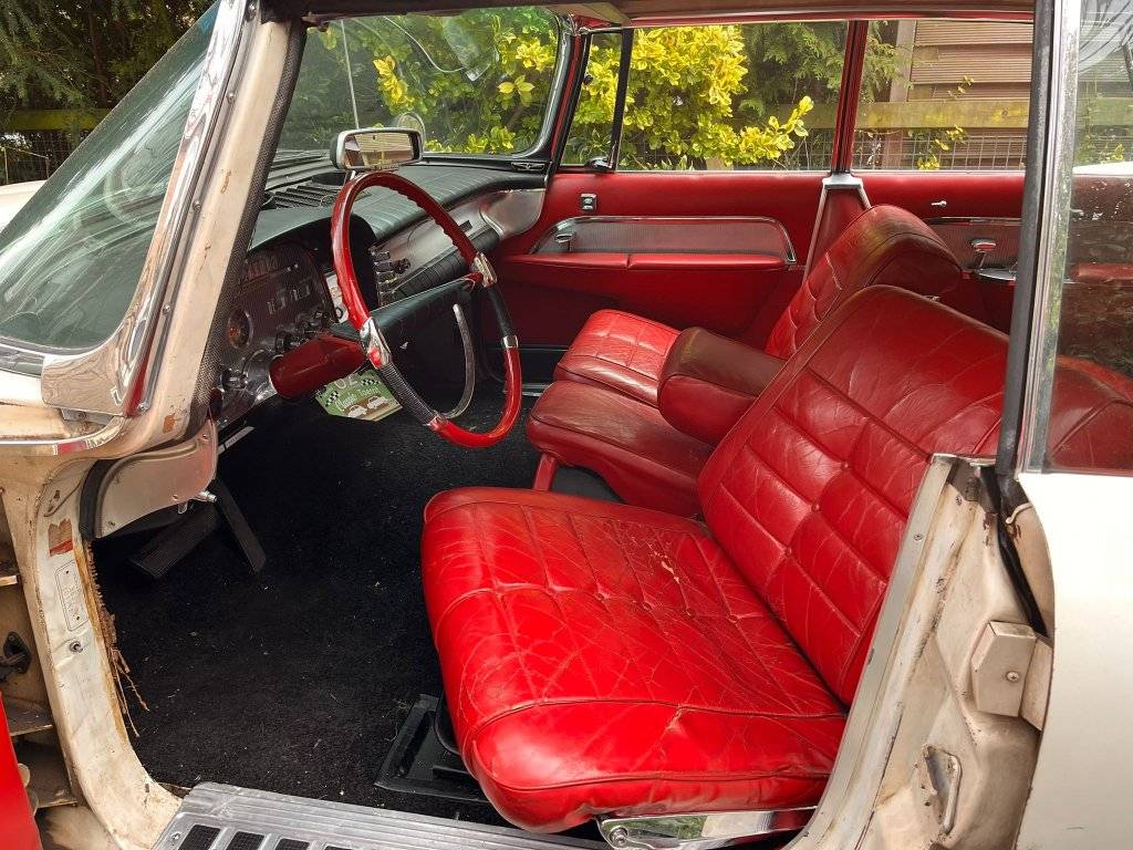

I just received some more pictures and to me, it all doesn't look to bad. The kick-panels seems to be missing, but I think I can make my own.

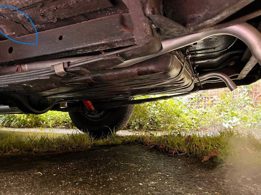

And there is one area where I am not sure it should be like that, on top of the rails, I circled it blue in a photo.

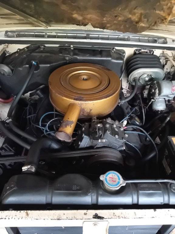

You mentioned it was aligned. Then it shouldn’t pull at all. I would be concerned and have a few mechanics check it out and the drive train. That’s an old Big Block Chrysler. Someone rebuilt it. A compression test and how the transmission shifts will tell you volumes. Parts for it will have a long lead time. It’s either going to be a museum piece or something to enjoy using. My old dodge isn’t perfect but, it brings me Pure Joy to drive.

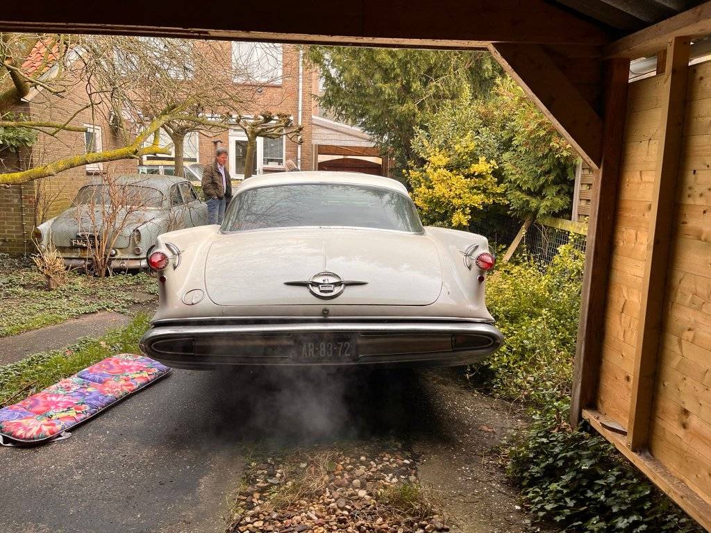

I received an video of it when idling:
Love the fins! Sounds pretty good. You probably already know this but, some old Chryslers and GMs reversed the lug nut threads on the driver side. Wish someone would have told me. Might save you a sore shoulder.

The spot you circled looks like a crack, which, worst case could be welded.

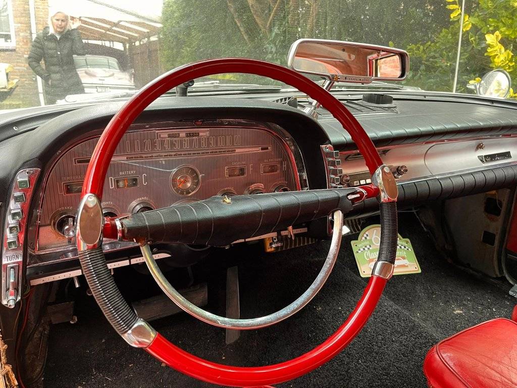

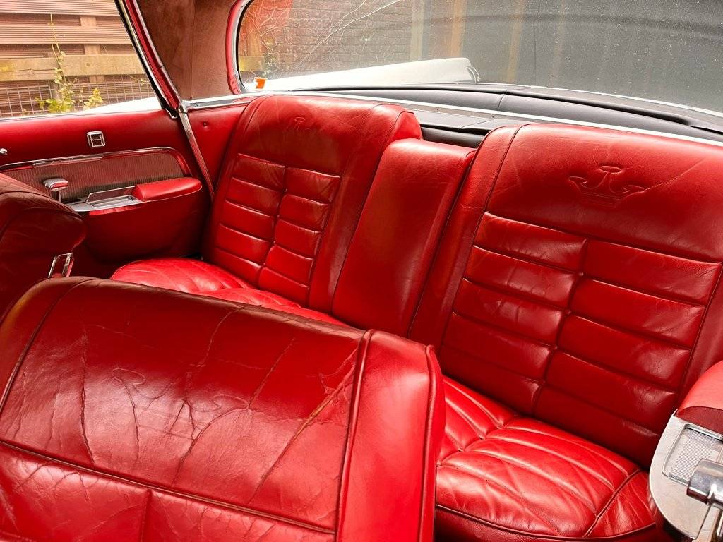

Nice looking car, and the red interior sets the polar white of very nicely. The dash is spectacular and something I could stare at for a long time.

The spot you outlined does not appear to be at the frame, but of course photos can be difficult to interpret. Otherwise the car looks nice. As the other guys have pointed out, the car is 65 years old, so there will be issues and sorting.

This car appears to have had "YES" written across the order form. I couldn't see if the car has a power seat, but it certainly seems to have every other option. If the seller will let you, take it to a mechanic you trust and have him check the front suspension, brakes and maybe even do a compression test on the engine. Are you able to take it for a test drive? Does it drive well, does it stop in a straight line? Does it make any unusual noises? Start from there.
