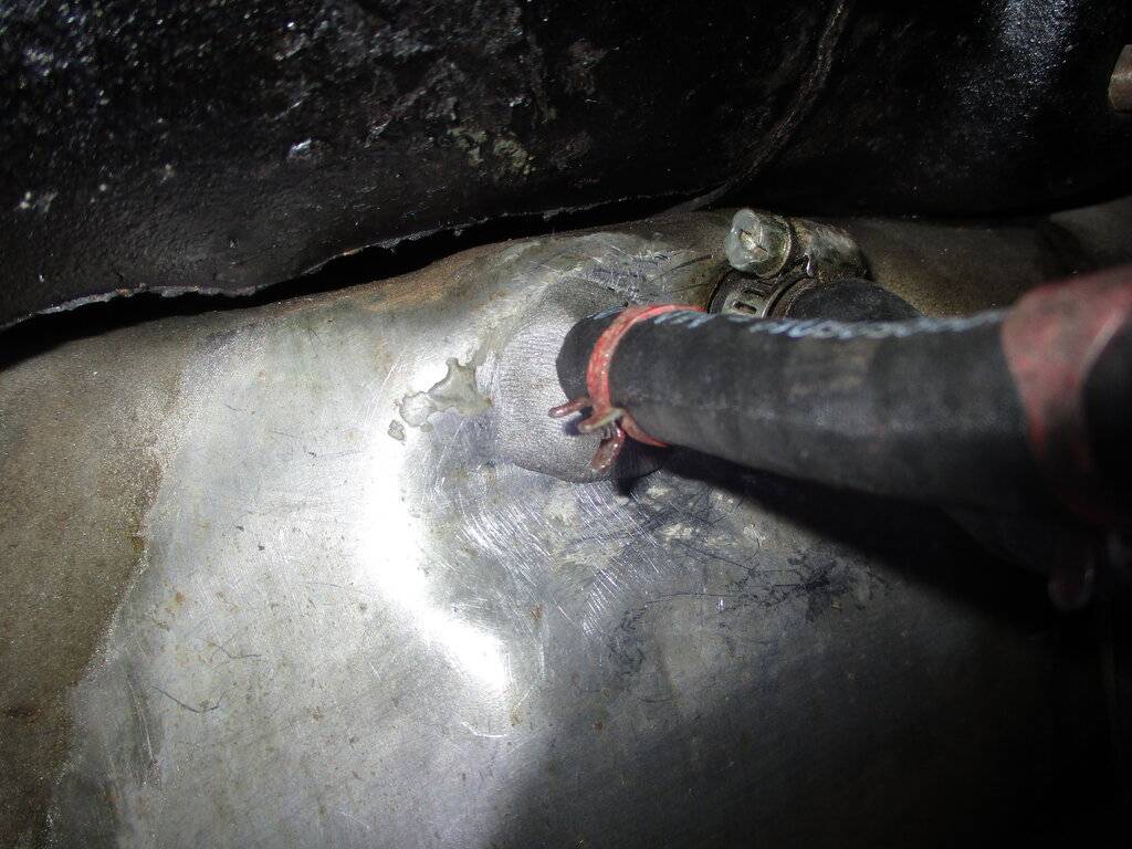

One of my tubes was loose and leaking. I used this at the joint where the tube leaves the tank. https://www.jbweld.com/product/tankweld
Make sure you spend plenty of time getting the surfaces of the tank and the tube thoroughly clean and scuffed up.
Perfect.
Note that the surface on the epoxy putty that almost looks like fabric is in fact my multiple fingerprints as I worked the stuff into place.
It cures in an hour into a rock-hard condition.
