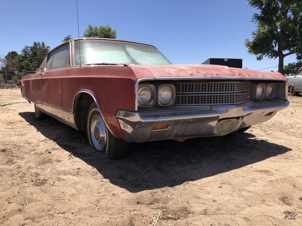

Hey all! I’m looking to see what my best bet is on finding some good headers for my ride. My ‘68 New Yorker is mostly stock. Aside from the engine being bored 30 over and the trans having a TF2 in it, it still has a 650 CFM carb and nothing crazy.
I am wanting to do a dual chrome exhaust on the car and run some 24 inch glasspacks. I don’t like the sound of flowmasters very much, I’m more into the furple of glasspacks! Case in point, I want to see what headers will fit my 1968 New Yorker with a 440.

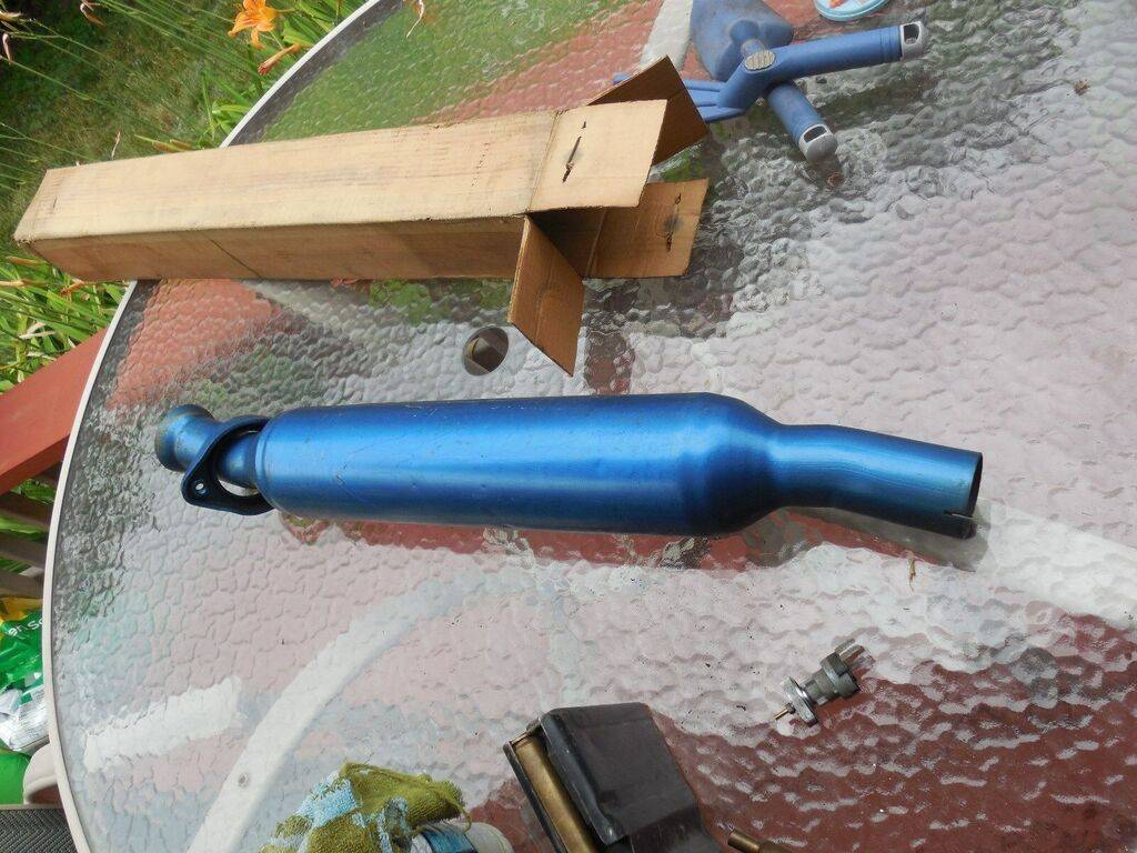

"In terms of glass pack mufflers, I would go without question with a pair of Walker Continental Blue Swingers. Discontinued, but there's a guy on eBay that sells them NOS. I bought two pairs from him for my Monaco.
They have that distinctive sound like no other glass pack, and were the hot muffler back in the day for our big Chryslers.

Here's what they look like, and a pair of them would be perfect for the way you're building your car:
