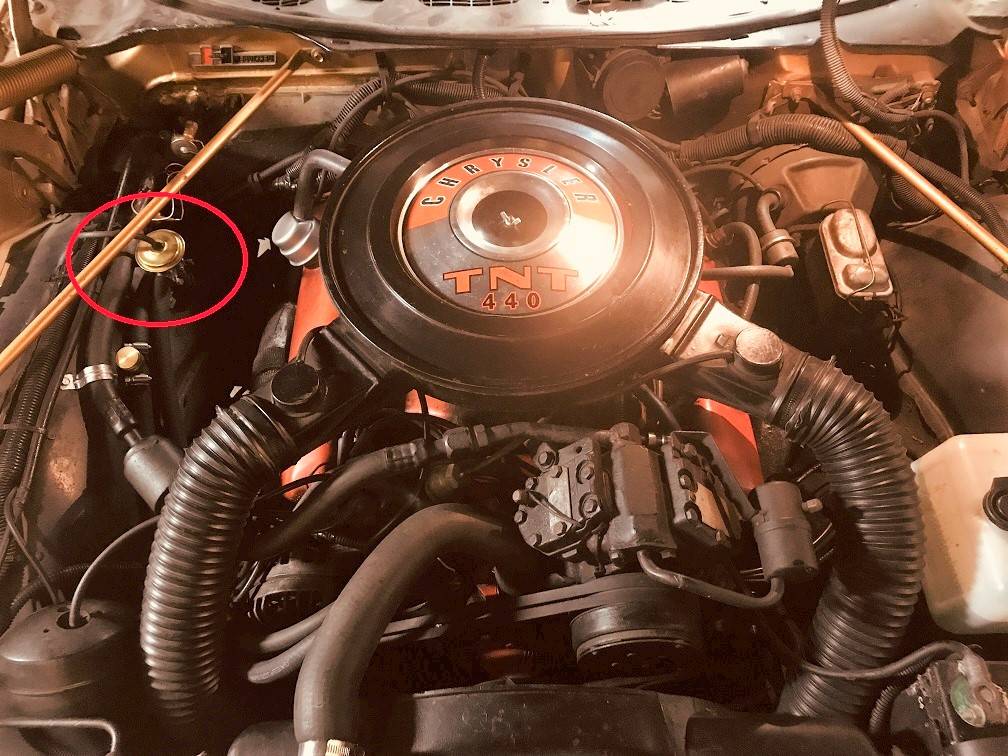

From my previous posts, you guys know I was having problems with the plastic Mopar heater valves starting to leak before 3yrs old on my 1970 300 Hurst. You guys also know I'm cheap, so I didn't want to buy a 3rd $120 valve. Maybe I have too much pressure in my cooling system which causes these to leak, I don't know. The problem was that almost all heater valves are vacuum close, plastic or just don't fit. The one I'm trying now is a $30 GM 1963-1986 steel one which is one of the few that is vacuum open. I had to buy a 90 degree heater hose since the pipe comes out the bottom, but I was lucky to find that a heater hose made for a Grand Caravan that fits. I also had to make a collar that screws onto the wheel well to hold it on. The car''s not going to win any awards but I try to make it look stock without breaking the bank.
Anyone see any problems doing this? I'll let you guys know if it doesn't last.
Looks good. There used to be some of the water valves which had a clip on top to hang from the fender-to-cowl brace, IIRC.
heheh, i dont think any one will notice the non stock heater valve, they will be focussing on your non stock air ducting ! :poke:

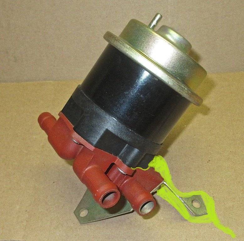

I certainly don't have a problem with it, as you can see. The correct OEM plastic/phenolic unit has been problematic since......1970. Or maybe it was 71 when they actually started leaking. The EVERCO replacement was what everyone did back then. And now. :)

Were you buying NOS heater valves or the reproductions that kept failing?
That's a good question to ask. In my case, OEM factory installed valves and then normal replacement parts off dealer shelves in the 70s and 80s failed miserably. Along came the inexpensive and reliable Everhot/Evercool replacement item. IIRC, it was available by the mid-70s. I have a hazy memory of installing them while I worked at a Chrysler dealership while in college ('78?).....we knew not to use the OEM item.
I certainly wouldn't use an expensive NIB NOS item now unless it was for a trailer queen.
I have no knowledge of the repro item reliability and functionality.

I tried NOS, then repro. I tried gluing it, then I tried one steel one that hangs, all failed within 3 yrs. One lasted 2 months. I was going to buy the one Trace has pictured, however at $140, I just don't want to keep throwing money at this problem. So over the last 6yrs , I've spent around $400 so far to fix this, so I went with the cheapest $30 fix. I might do what big john said and gut the original to make it look stock, but I'm too lazy now. Maybe some other year, I'll get to it. Thanks for everyone's post.

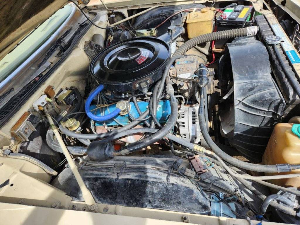

Love the fresh air set up. Did you modify the snorkels?
Sorry for changing subject.
