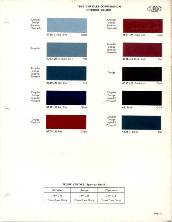

I have done just a few searches on this, found the 70 hamtramck pages, but need to find what paint code may have been used on my red interior 66 fury. Have not found a build sheet. Anyone have suggestion on red paint code used on things like the console in 66?? thanks
Might try the OEM Paint Color pages at www.TCPGlobal.com . In addition to the paint chip samples, if there are two pages of paint chips, then on the 2nd page should be the colors and codes for interiors and possibly the trunk floor and such. Usually, the interior colors could match the outside color for "color", but have a slightly more satiny appearance rather than a hard shine?

Great Reference Site
1966 Color Codes - Plymouth Paint Cross-Reference

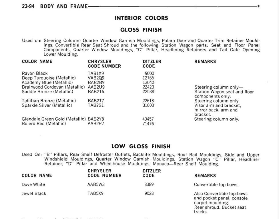

This may be in the FSM. The downloadable version seems to be missing a bunch of pages, so I don't know if a real '66 Plymouth FSM has this info. If you download a '66 Dodge version or a '65 Plymouth or even the '65 Chrysler version, you'll find the codes. MyMopar
Here's a screen shot of a portion of the '66 Dodge for example. This is just part of one page and you can download and peruse the FSMs that I suggested.
But if you have a good copy, like an original paper version, look in the body and frame section. I can't tell you if it's there, but based on other FSM, it should be. If not, I'll bet the '66 Dodge version will get you pretty close.
Sometimes, you have to look a model year forward or backward, which used the same colors, to get the codes. My '66 Chrysler paper manual did not have the interior codes in it (for our '66 Newport Town Sedan), but the '70 Dodge paper Full-Size FSM had the codes for my '70 Monaco Brougham in it. So sometimes, you have to look in the similar cars of the different Chrysler divisions to find some things.
