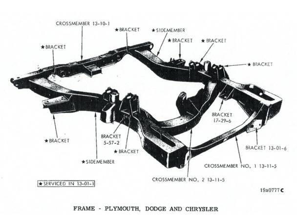

Jump in and assist with the specifics, but a 73 C body has a completely welded "stub frame". It's one piece...no "K frame" to unbolt or change when swapping different sized engines. The only difference that I'm aware of, is that the Imperial stub frame is 3 inches longer.
I'm a relative newbie in the C body world but that's what I've learned in the past year or so. Please correct me or add to this information.

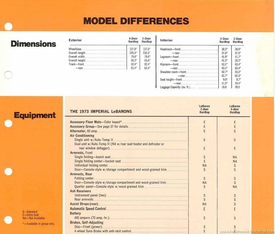

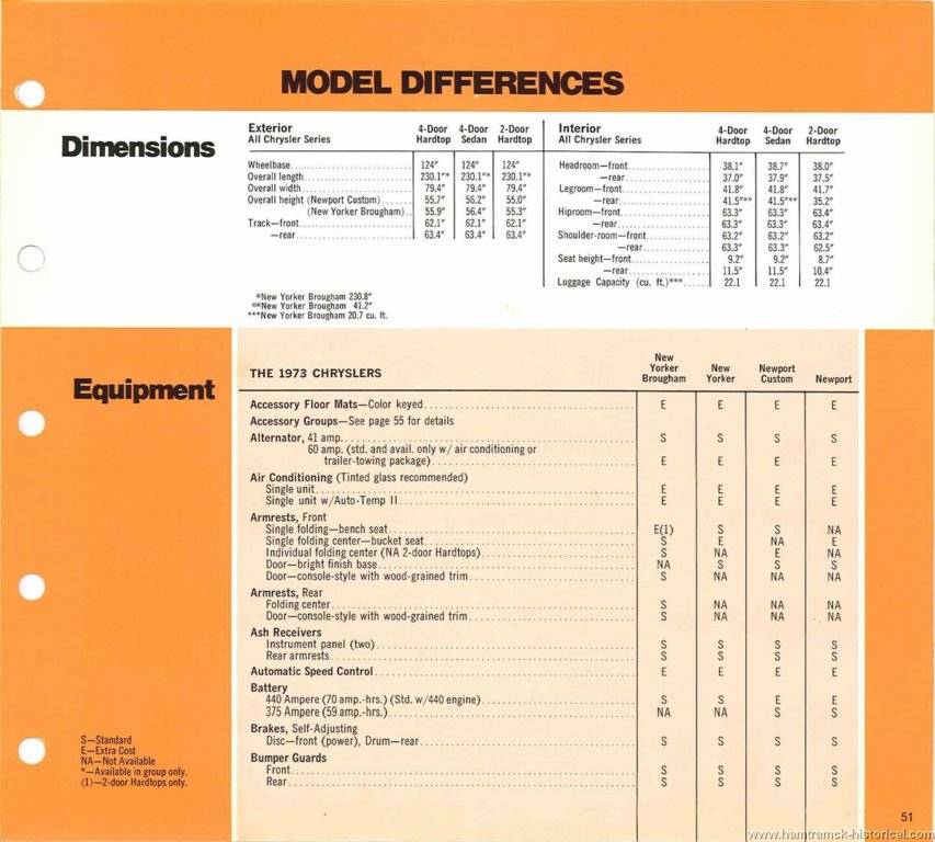

They (Imps) had the rubber isolators on the chassis prior to 71, when lesser makes got them for the first time. Touching the subject, Imperials´ had also heftier steering axles, longer torsion bars (obvious), etc.
Interesting that the whole difference in wheel base from lesser models was all from the cowl forward on the fusies.
Actually (73 in question) Chryslers have 1.6 cubic feet more trunk space than 2dr Imperials, which have 1.9 CF more than 4dr Imps.
