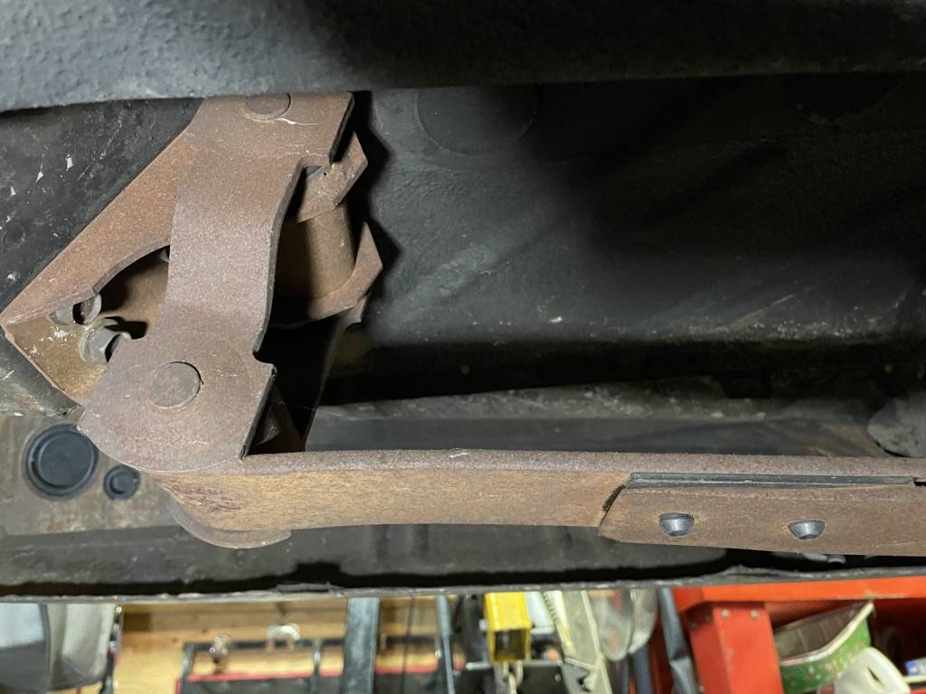

Any idea what is special about Imperial leaf spring isolators for 67/68. Fuselage years listed everywhere. 67/68 not so much.
Imperials have a lot of parts on them that were probably rated for use on Dodge trucks. These were big, heavy cars and they were built accordingly. Glad to hear you found a good source for your springs.
First time I saw a Fuselage Imperial on the rack at the local Chrysler dealer, my first reaction was "Those rear springs look like they need to be on a 3/4 ton pickup truck", FWIW
