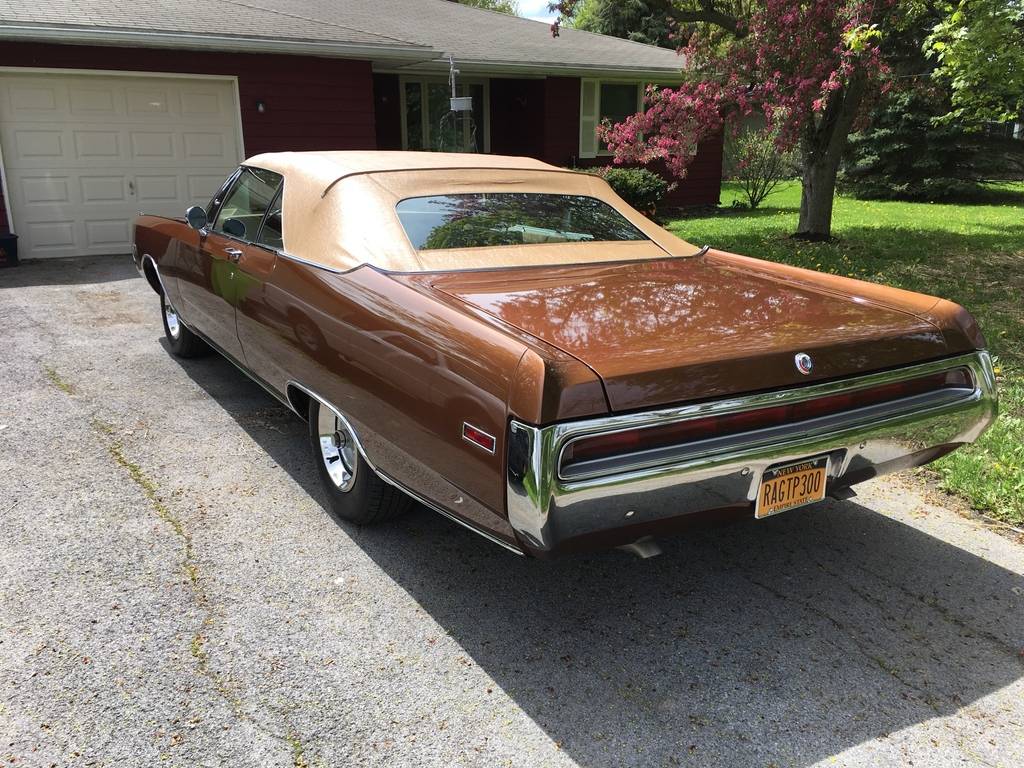

Hello, I recently posted a question about putting some slightly wider tires (and ergo, wider rims) on my 1969 300. I'm leaning heavily towards 235/70/15s up front and 255/70/15s on the back, running on seven or eight inch wide rims. I know it may depend on what brand/type I get, but will I need spacers and if so, what size?

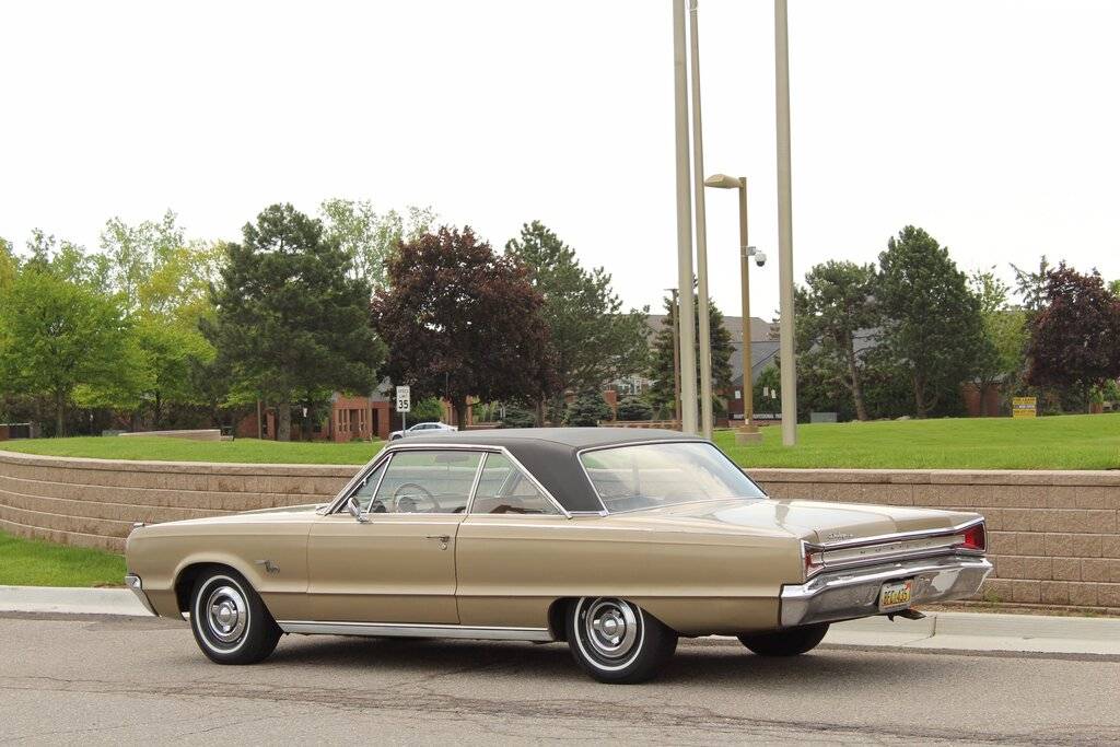

I have a set of 235.70.15 tires on 5.5in rims now on my GT and they sit fine, I think a 7in rim may be a bit much for 235/70s.
