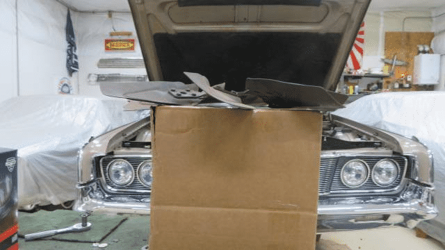

Good Morning All
Have done some more research on the radiator/fan clutch issue.
It would make sense that overheating in slow/stopped traffic MAY be caused by a lack of adequate air flow. All seals are are in place so that leaves the fan. As stated, water pump was replaced (440 source).
The car did not originally come equipped with a fan clutch so my research as research shows that the Hayden 2747 is listed as a replacement. That now leads to a replacement fan as solid fan drive is different. I have a couple of clutch fans in the 'stash' A Mopar 2863215 and a GM from a '66 GTO. Both fans are the same diameter (either 17.5 or 18, hard to measure), number of blades (7) and mounting dimensions. The only visible difference is the blade pitch (photos below). Both will mount up with about .75 inch clearance from the radiator. Apparently Mopar Performance recommends .5 inch but it should still work,
The GM fan appears to be more aggressive that the Mopar. Other than possible noise, (and the fact that it is GM) would there be other down down sides?
Thanks to all who respond.
Omni
Mopar Fan
GM Fan
I would still take a look at your tune . I had no overheating issues with my 75 Imperial except for once when I forgot to reconnect up the pcv after working on the carb and it was running lean . If your initial timing is to late the combustion process will still be happening while exhaust valve is open thus super heating the coolant passages .
I also have a 68 Barracuda running a .550 lift 222/229 duration cam and a 69 Dart with a 408 stroker and a solid roller .648 lift 246/250 duration on a 108 . No overheating issues even at 100+ temps . Both cars have factory style 7 blade clutch fans . Both also run cheap Champion aluminum radiators but I don’t think they cool much better than factory brass units .
With the fan shroud, the issue is placement of the fan within the shroud and how much "sticks out" on the engine side of things (like about 1/2 of the fan itself?). Nearness to the radiator is also important in order to get a more uniform pull on the air, through the complete radiator rather than just in front of the fan (which is what the shroud would assist with).
For potential "tissue rejection" issues, start with the Chrysler fan and see how it goes. Progress from there.
